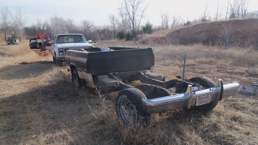

Does this call for the same cable on a Regular Cab Long Bed that you need? I'm not sure where the truck length is made up, but I have a spare 85 C20 Long Bed that has the the Park Brake Cables on it still. If it's the same, and you give me a couple weeks to get out to my dads, I can get the cable off the frame and you cover shipping. It'll probably fit in a small flat rate USPS box.
This bed has long been sold too, so it shouldn't be to hard to pull this cable.

Glad you got it handled. I did check my C20 truck frame for that cable when I was out there a couple days ago and I do have it if you needed it for back up plan. Guess I get to keep it afterall.
