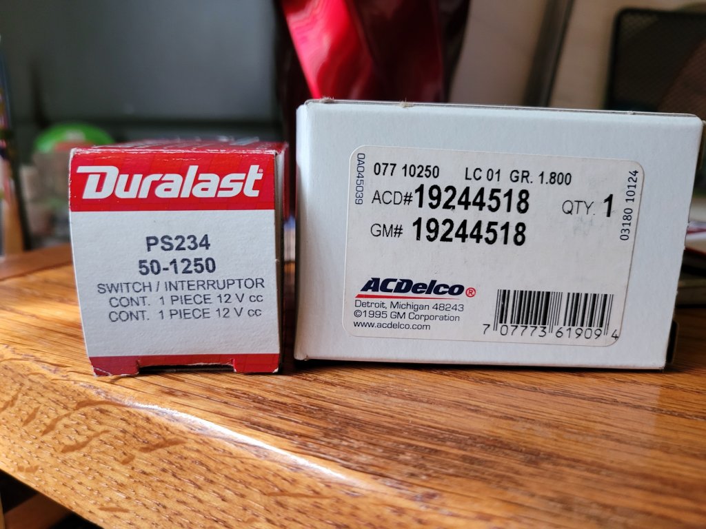

unless you have a short to ground in the 440 (orange wire) circuit. that can cause all sorts of havoc. 440 feeds power to ECM, oil pressure switch, and fuel pump relay.
I had one do exactly that earlier in the year. This was a replacement for another (same brand - Warrantied) that leaked and always made the oil pressure light turn on until the engine lost pressure, AFTER the switch was turned off. This replacement did the same thing, until it left me stranded after blowing the fuse.
The new AC Delco works correctly, just like original one.
Aftermarket can't even make a simple oil pressure switch anymore!
