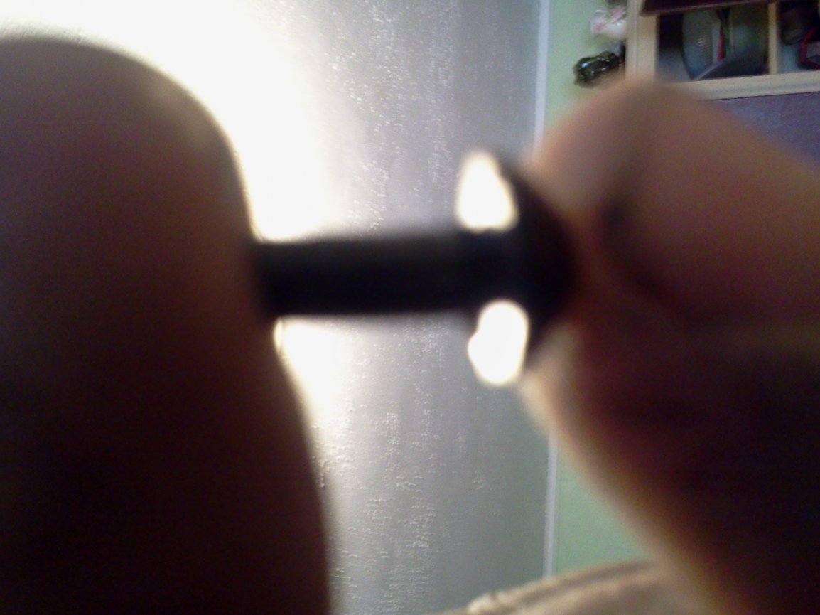

On a side note i found some wierd things in the pan. a liitle piece of a rock
a small washer
and this thing
