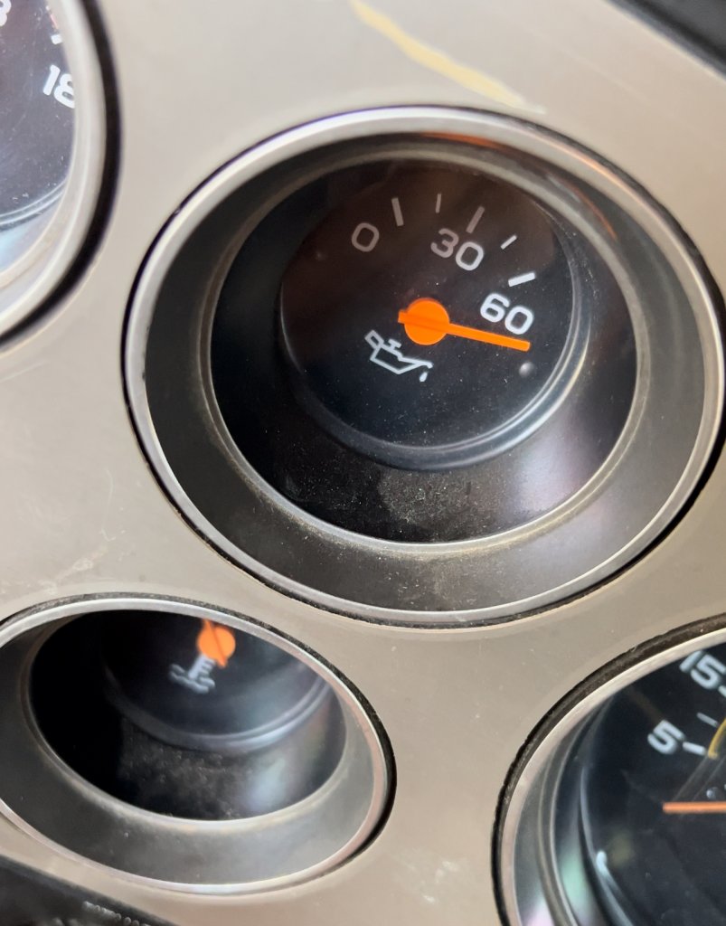

Howdy, I recently noticed my truck giving me seemingly strange high oil pressure readings which didn’t correspond with the actual pressure, after replacing the gauge, and the sending unit (which was accidentally purchased for an 85 350 instead of a 71) it’s still getting irregular readings, more erratic actually, any help or insight is great, thanks. The needle is bouncing in the higher end past 60 psi, until I give it gas and it settles down a little.

You can always "T" in a mechanical gauge to get a second opinion.

I have a oil pressure reader coming in tomorrow I’m going to connect to see if it’s actually getting readings like that, I guess I’ll be updating this thread tomorrow

Okay, just got done with Manuel oil pressure test and it’s running normal, not bouncing, about 35 psi. Looking into if there’s a ground or something else going on

Your gauge and sender should match the year of your truck,why are you using 1971 parts?

So it’s a 1985 truck with a 71 350 that had been previously swapped into it, I accidentally ordered a 85 pressure sending unit instead, but they looked identical. I didn’t know if it would make much issue

Well you accidentally ordered the right part. Use the 85 sender,do not order a 71 sender

You didn't by chance use teflon tape on the threads of the new sender? Also, check the wiring at the sensor connector.

I didn’t use any, if it didn’t come with it already on, what does that cause?

No worries then. Teflon tape on ANY sensor will insulate it from ground.
