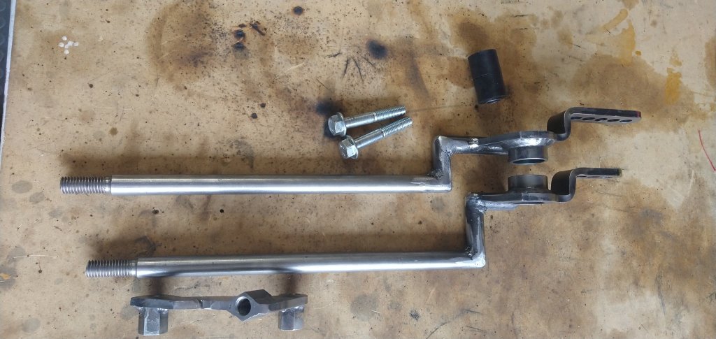

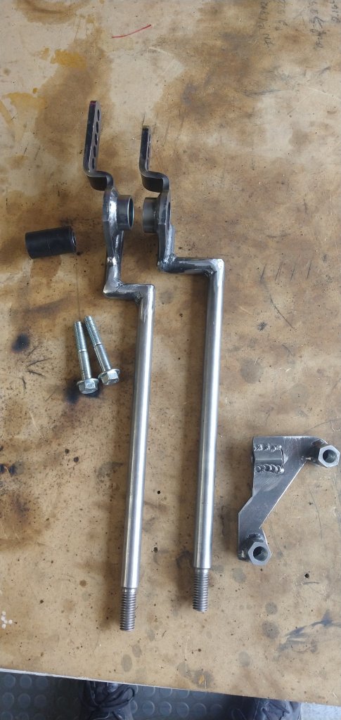

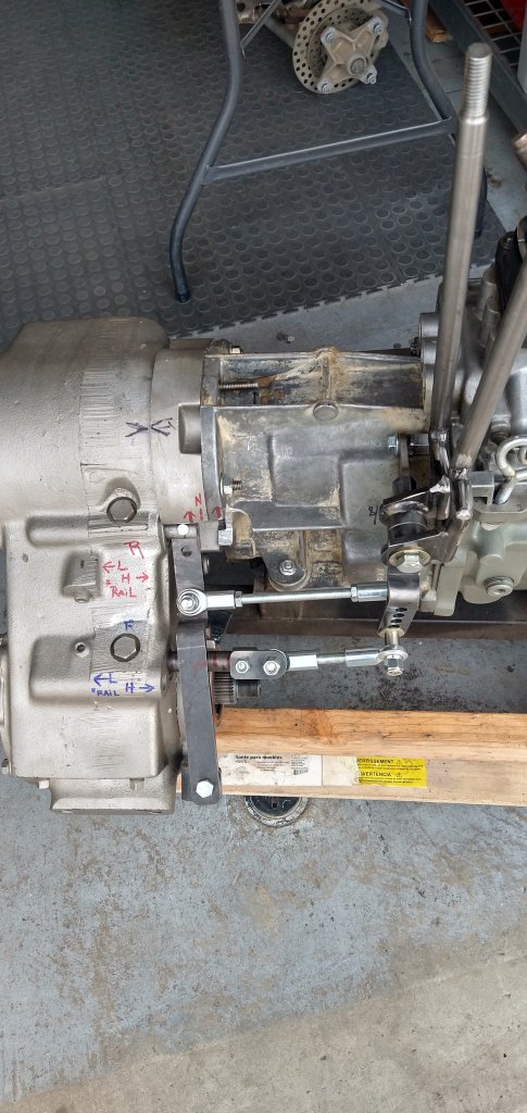

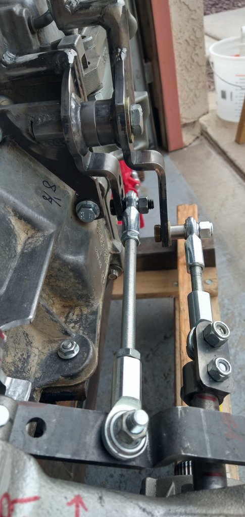

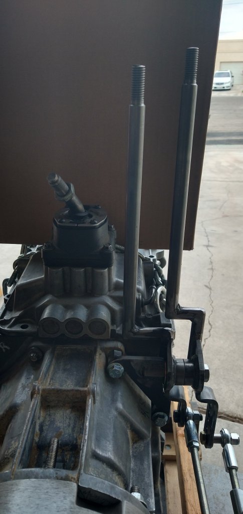

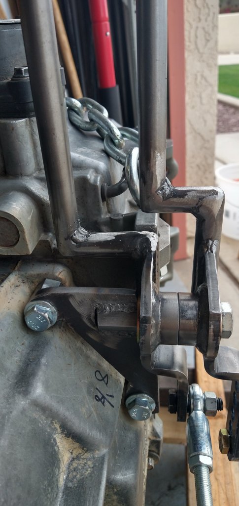

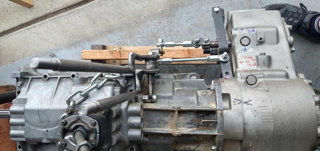

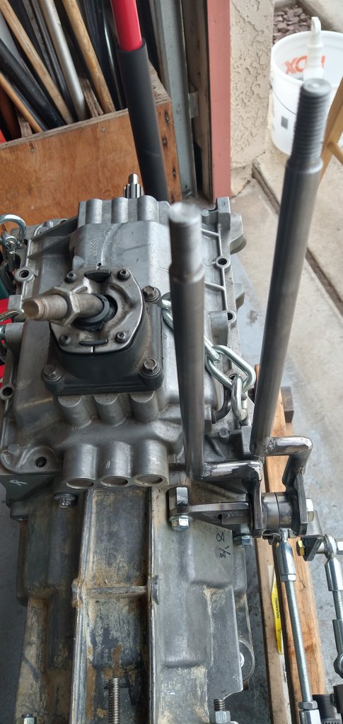

Odd coincidence. I spent the day modifying the shift levers on my Twin Stick" 205 to live happy next to my NV4500. I have a new ORD floor mount twin stick that was going to go behind my now obsolete TH400. Since ORD is months backordered on shifters I had to modify it to mount to the 4500. This put the shifter too far to the PS and off the hump. Since I don't have a torch, I had to cut them at 45 degrees, rotate and weld them. Did the trick. I'm going to lose the factory 4500 shifter and boot assembly. It's just too big. Stand by...pics coming.
SquareRoot
Mar 18, 2017
4,343
8,454
Arizona
85
As promised. Regarding the OP's question, I don't see any way the OEM 4500 boot will coexist with the OEM 205 bezel. They are too close together without modifying one/both.

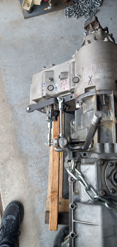

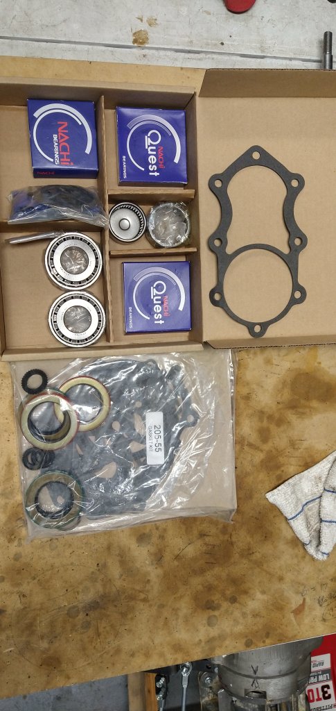

My ORD overhaul kit for the 205 showed up today as well. Woohoo.
