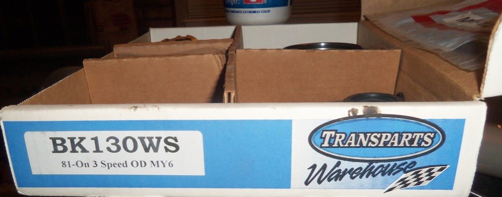

Did your kit come in a box similar to the one I have pictured a few posts ago?
47,210
9,482

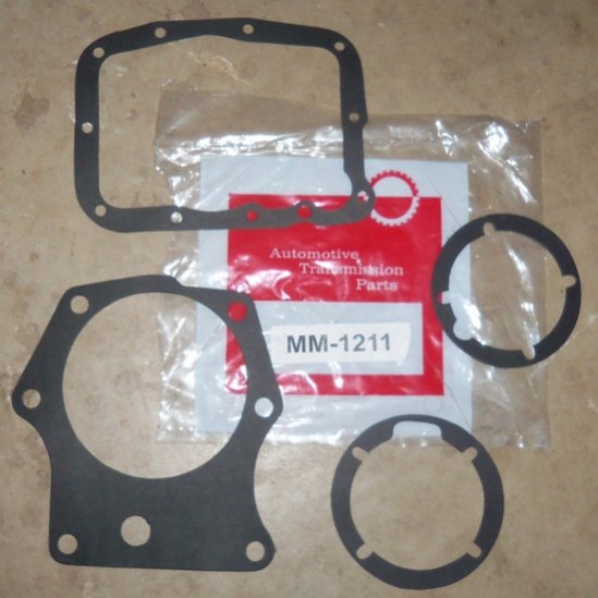

Here is my kit # and my gaskets.

Cracks me up, people say these transmissions are weak. I just noticed Dodge used them in 77-81 Trucks with 400 and 440cu in engines. Same rebuild kit for all the Chevy's and Dodges. That's probably why the rear gasket doesn't fit.

I noticed on Drivetrain.com, that the same Kit # is the same for all models of the A883, including the Dodge OD units. Do keep in mind, the OD A833's are different from the Non OD units. I know the side covers are even different. And the Kit ends in WS for With Synchros

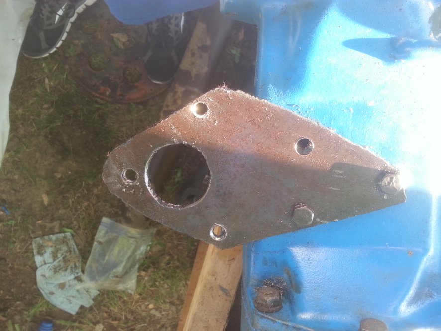

Heres my homemade mounting plate to put the 2wd onto 4wd adapter.

That looks like it'll do the job. All you're really needing to do is go straight up with the mounting where the 2wd plate has an offset pushing the shifter more toward to the firewall, probably to center it in the hump, where the 4wd is back further toward the seat to match the Tcase stick.
