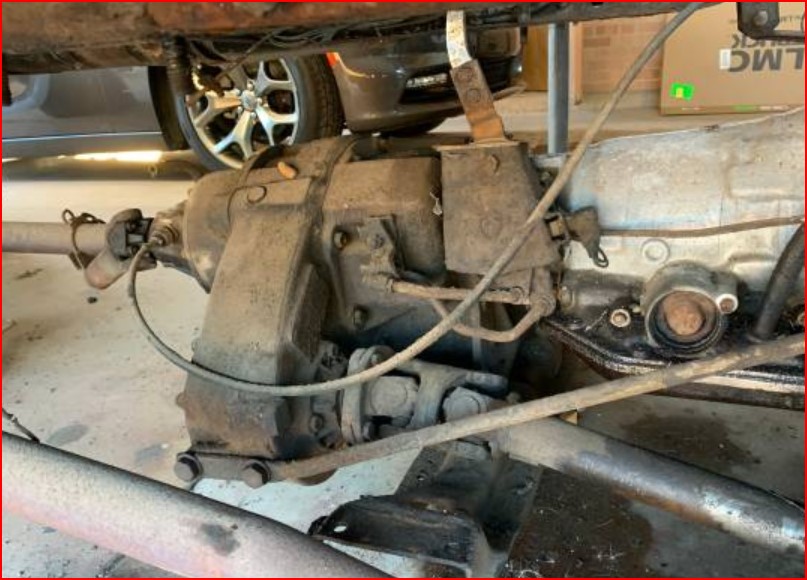

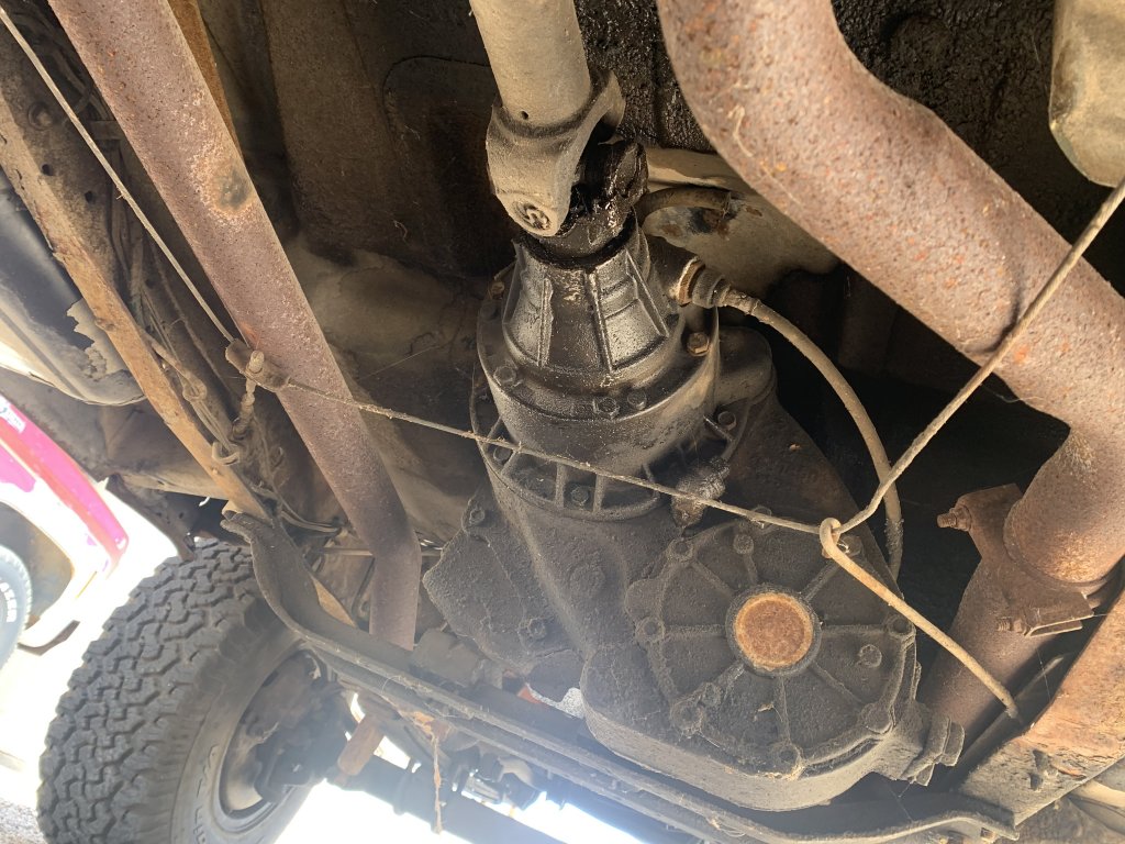

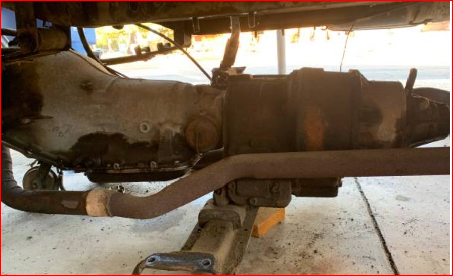

The 208 isn't as sturdy as the 203 is, so if strength is an issue a 208 isn't the case for you. You will also need an adaptor and drive shaft mods as well as shifter mods. The 203 is quite a beast and its large and heavy (all iron + chain). Easiest route is to pull the 203 and put a part time kit in it. Have it rebuilt and replace the old chain. Then add part time hubs. Warn and MM are good choices. easy to do by your self with you tube as a guide. Once the 203 is built you will be good to go for the next 50 years.
Best of luck my friend!
