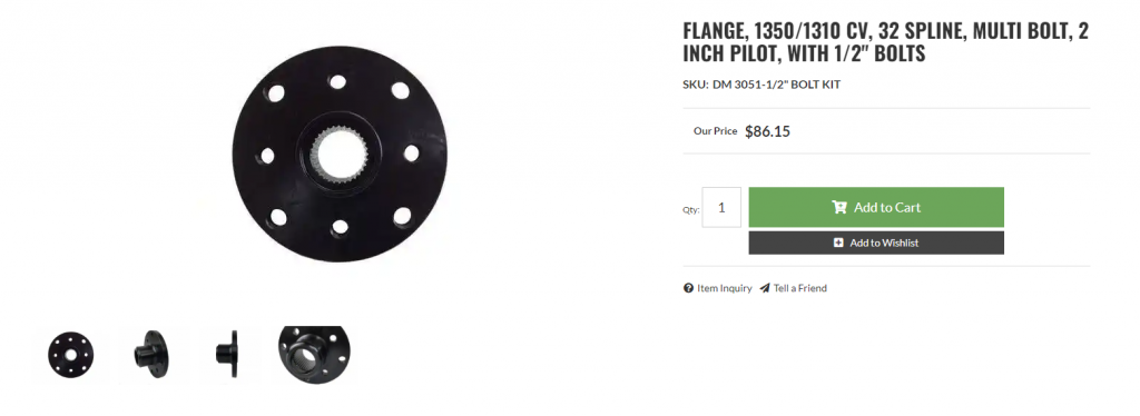

If your getting a new shaft built, you also have the option of using a flange yoke. I really like mine and it eliminates the U bolts altogether.

Another flange vote here.

If you’re getting a new shaft built, you also have the option of using a flange yoke. I really like mine and it eliminates the U bolts altogether.
Great idea, I did not think about it and the shop didn’t mention it.
