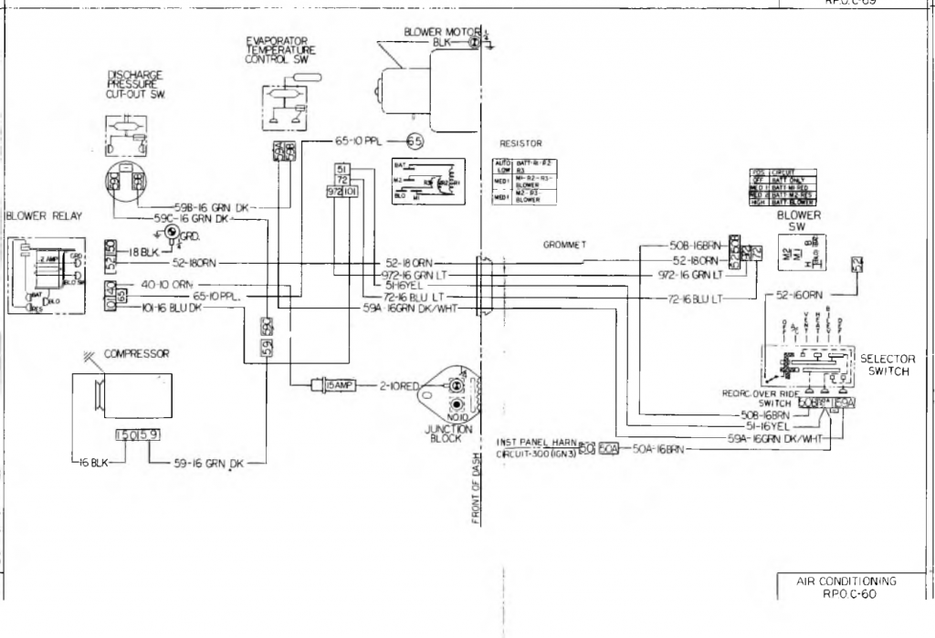

Was your truck built with AC from the factory? If so it would have a POA system, truly a very cold system when operating correctly. Being a 50 year old truck, pictures of the AC pump and pressure lines will help us, to help you. The system could have been changed or added on.
The wiring to the pump has a diode in the power wire (at the plug) to protect the switch contacts. They fail. Testing with a jumper lead to the battery to the clutch and a second wire to ground the clutch.

Joel

Thank you all for the help I've followed the wiring diagram from the post and I have 12v up to the ac relay that I have already replaced. There is power coming in but I cant read any power leaving.
So the switch in the heater/AC control needs to switch power to turn on the relay. Fuse for AC/heater? Next pull the dash bezel and loosen up the control at the dash. Move it out enough to check power in and out from there.
