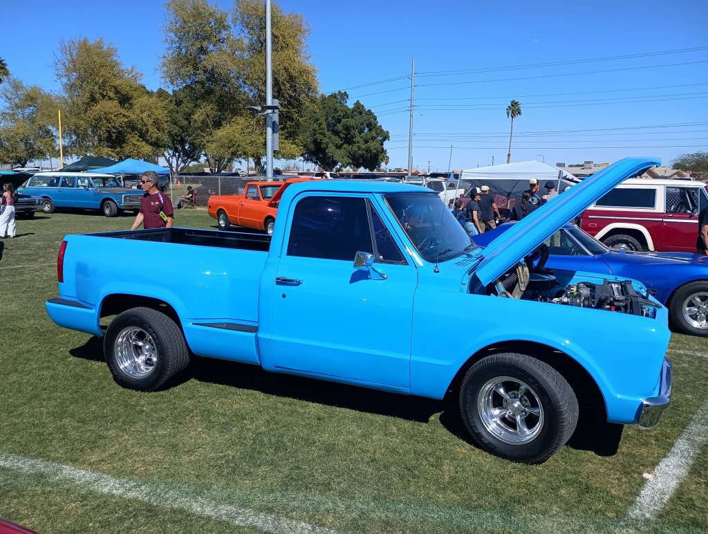

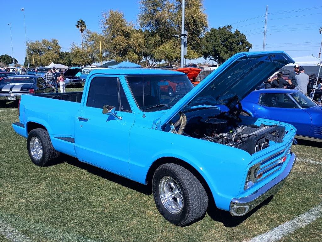

I saw this at a recent car show here in town. I think it's actually a great looking truck.
Not a square, but I like them too.
The purists will blow a gasket, but I like the way the feature line on the door aligns with the top of the step.
