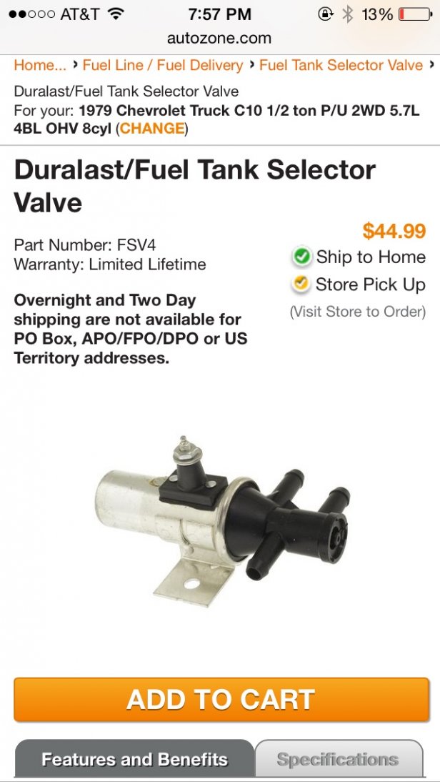

It's definitely worth it. Your range with that one small tank isn't gonna be anything special. It seems like you're saying the selector valve was bypassed where only one tank would function. Well, the guy who owned it might have clogged up the valve by sucking trash out of that decommissioned tank, and he just bypassed it and went on. If the wire is right there or close by, which there was no reason to disturb it, you should be able to blow out the lines, put a new sock in the tank, replace the selector valve, and be good to go.
