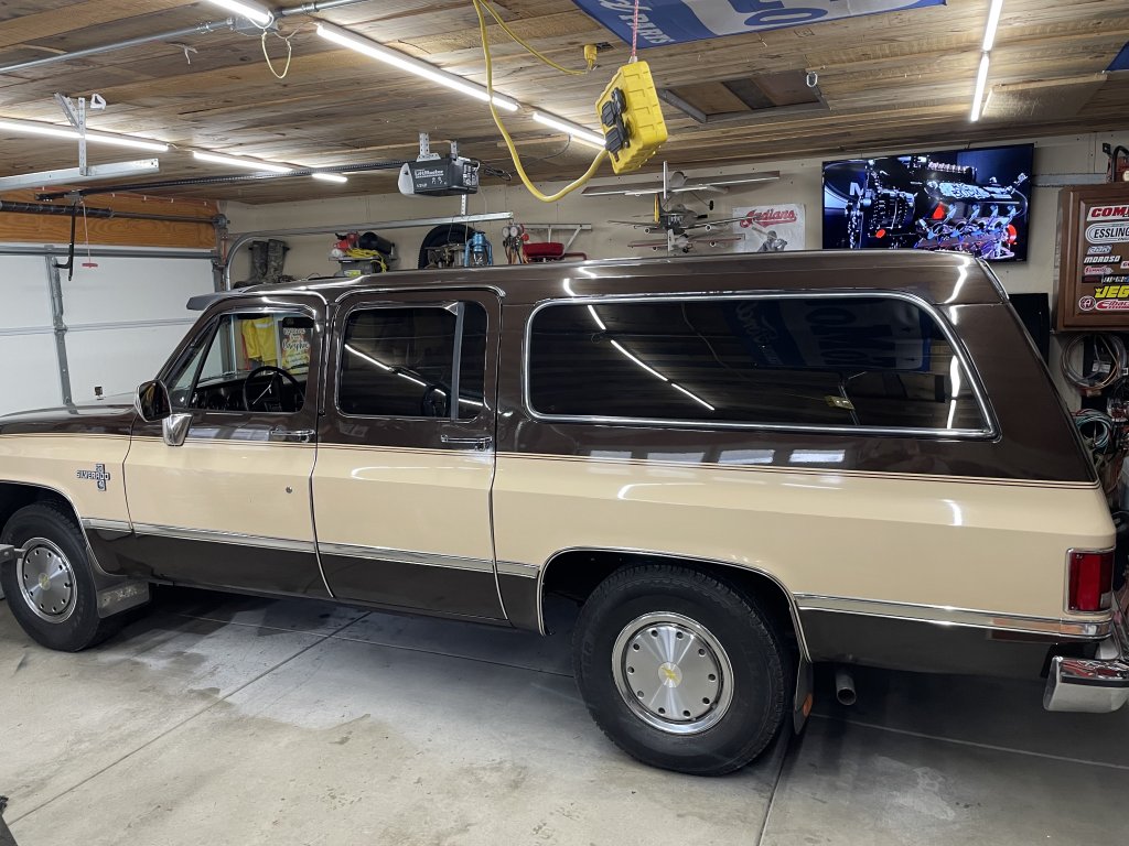

What would cause the wipers to cycle one time when i go to start? Occasionally is doesn't do it but most time it'll wipe once.

I've had gm wipers wipe like your saying and even would wipe once in a while using the turn signal. I'm guessing wiper switch would be where I would look first. Also do have pulse or std wipers?

Never had it happen but would look for bad ground 1st then bad switch. I always look for cheap stuff 1st, Plus most odd ball electric stuff will be bad ground. I once seen turn signal with a bad ground flash like a rxr crossing warning light.
