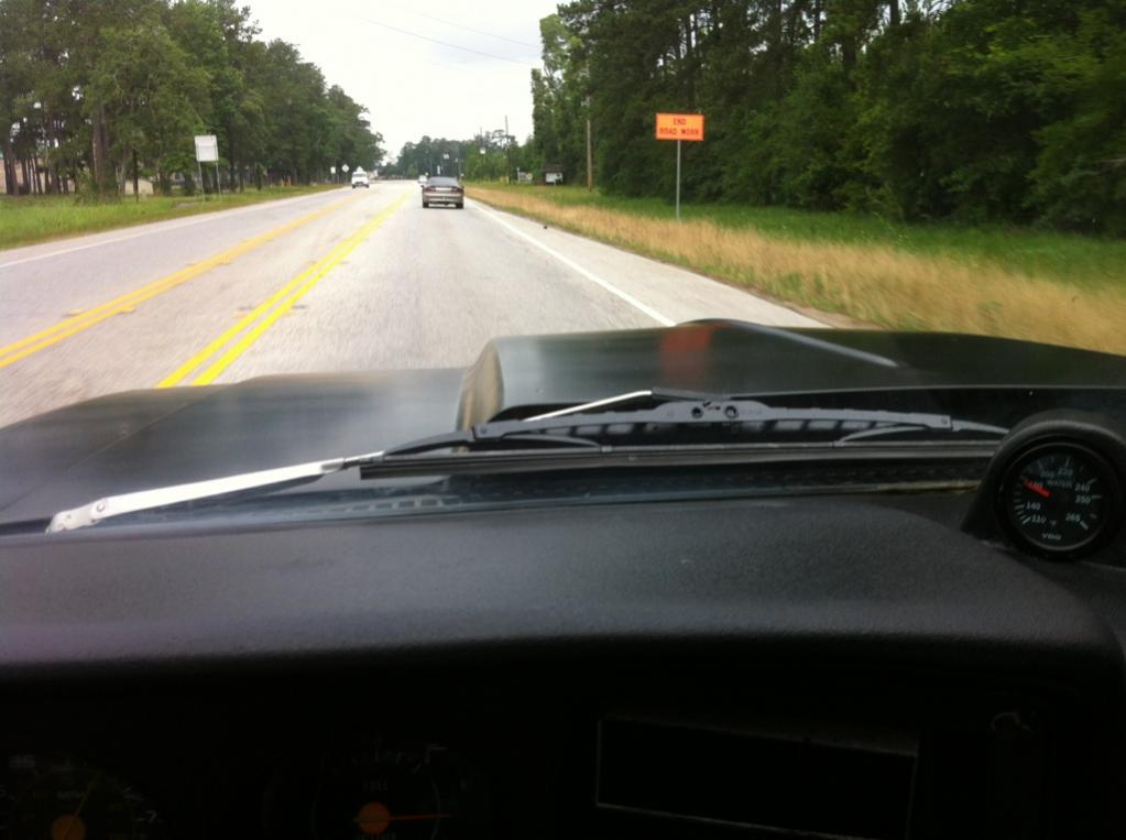

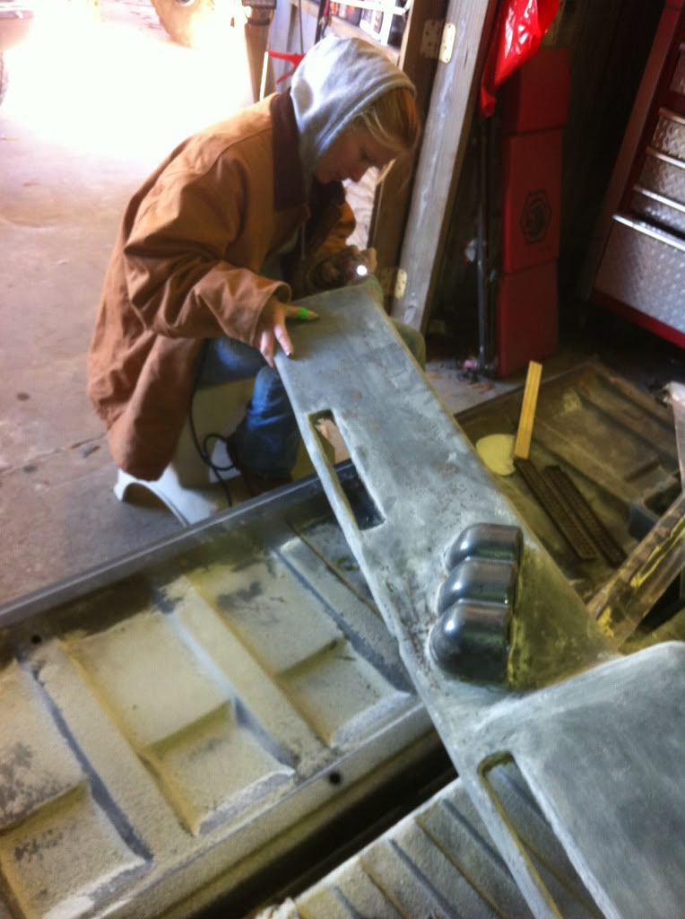

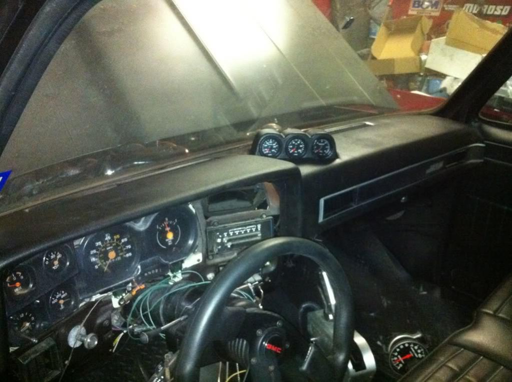

Here are some pics of an oem dash fiberglassed with undercoat/bedliner sprayed on. It is suprizingly smooth to the touch.

Ok ima do that SOON. I like that JKnight
