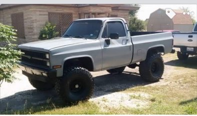

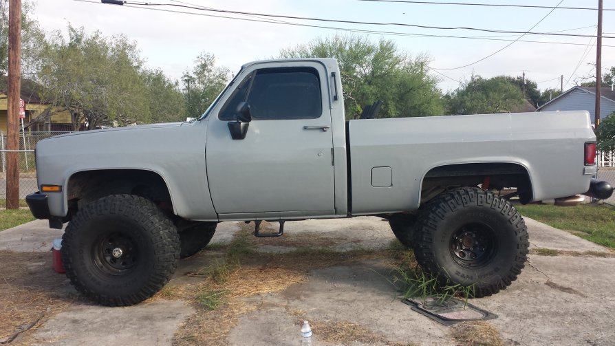

Please advise on what I should do about the transmission issue. The truck has 38 in tires and I want to make sure the transmission will be able to handle the stress of those tires.
I am not sure how to post pictures. I would definitely like to post some of the truck for you.
