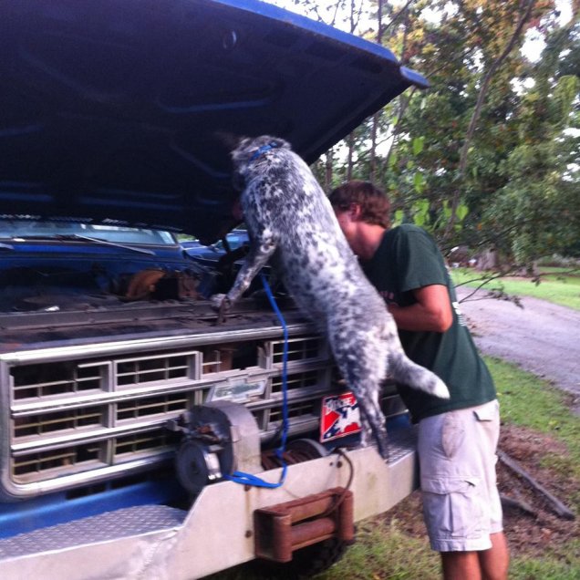

Hi Guys, I just bought me a 78 k10 stepside for $1800. Runs and drives fine just needs some TLC. It has a 350 and np203 t-case. Can I replace the auto locking hubs with manual hubs? I have heard that I would need to buy the part time kit to do so. Anyone know? Let me know what ya'll think about it, oh and my main mechanic helping me out a little under the hood :waytogo:

Good helper you have there. I swapped my auto hubs with manual hubs, all I did was buy the M/M (Mile Marker) kit, and followed the instructions.

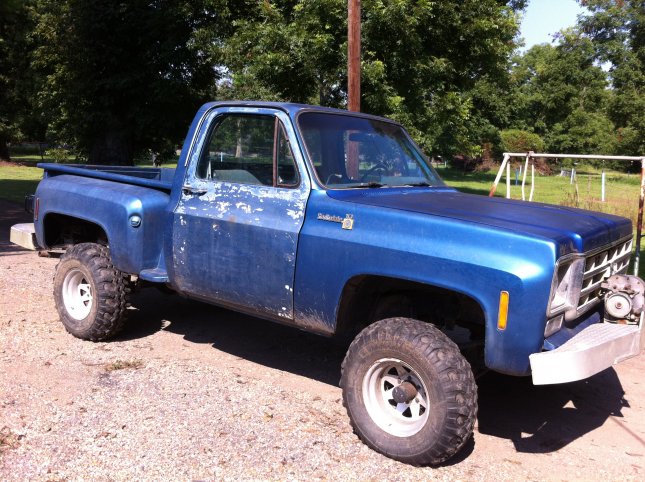

I like that winch, Is it a Belleview 6,000 pounder ??? Front bumper looks good too.

Damn nice truck,, and i had a helper like yours till the coyotes ganged up on her.......ask crazy for off road,, he seems to have the same coyote problem..........
Fuggin coyotees.

Thanks for the welcome guys! It is a th350 transmission. I guess I will stick to the auto hubs then. I'm not exactly sure what the winch is, I haven't checked it out too much cause the motor for it is behind my seat needing to be rebuilt!

Sorry to hear that, I know If anything ever happend to her I would be so upset, she goes everywhere with me
Might just need a good cleaning and a lube job. Those are good winches and in some places highly sought after.
Remove the side cover and flush it out, change the oil and it should last a very long time.
I drilled a hole in the bottom of Mine, tapped it for a 1/8th inch pipe plug, so I can drain it and change the oil annually.
Here`s a price on a motor. Made by Prestolite.
http://www.discountstarterandaltern...heavy-duty-4-field-motor-46-3650-mht6101.aspx
