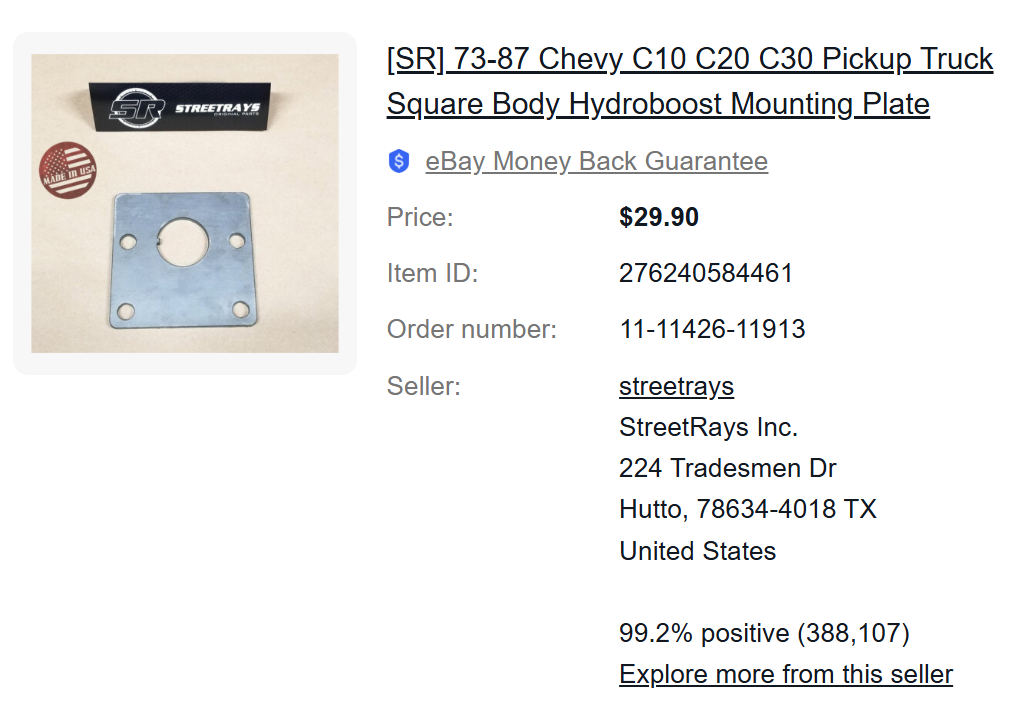

I can't find the part number for the hydro, but just so you know it wasn't quite a bolt-on fit. The factory studs were a bit too short so I remember having to drill them out and put longer grade 8 bolts in, and a plate like this to index the hydro unit.
You answered another question good job!
