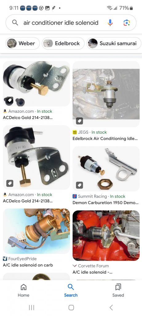

You should have a solenoid that kicks the idle up when the A/C is on . Search for Air conditioner idle solenoid on google,see what you find

OK, thanks. I found the Edelbrock one that goes with my carburetor and it’s pretty high dollar for $245. Just wondering what other options might be cheaper
maybe this? ACDELCO 2142138

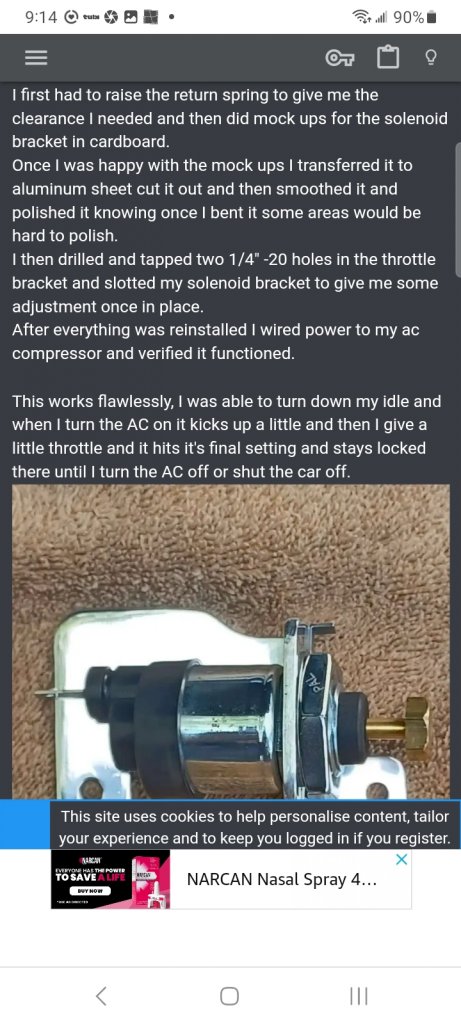

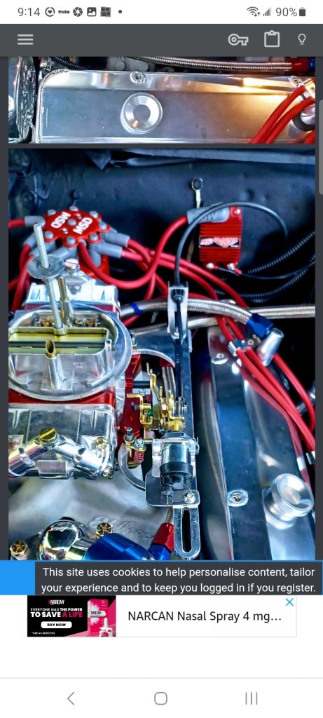

The Edelbrock performer carb is a reproduction of the Carter AFB Model C Used by GM through the mid 60s. Also Mopar used a similiar AFB carb. It's a shot in the dark but see if you can find a cheap used one for an AFB on Ebay. Th8s guy made his own bracket and used a Corvette solenoid.

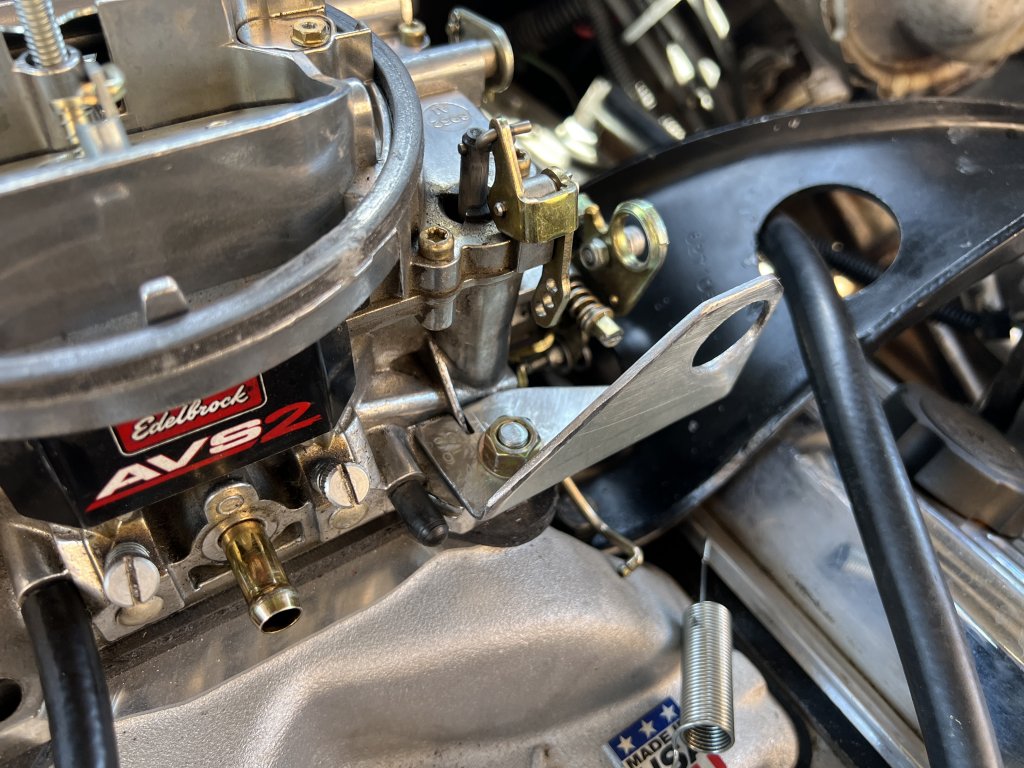

thanks. my buddy has a plasma table and is gonna cut me an “edelbrock” bracket. found a reasonable solenoid so now i know my plans for the fourth.

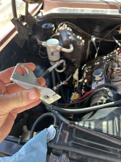

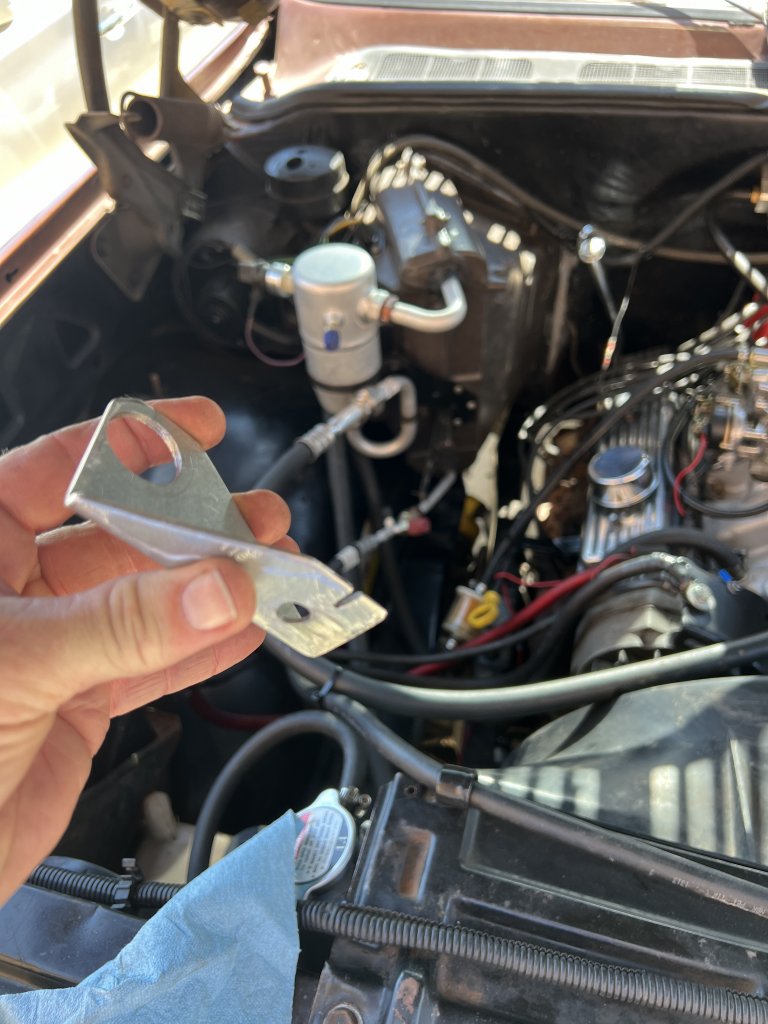

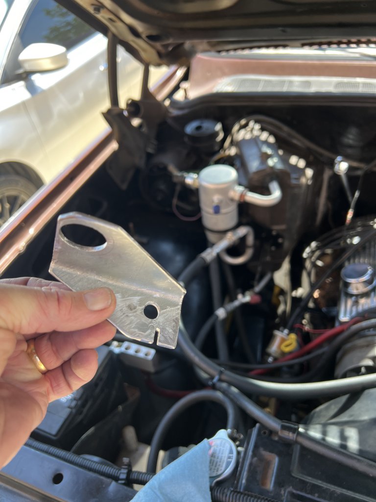

all good! cheap Standard solenoid and cut my own bracket. $65. works like a champ.
