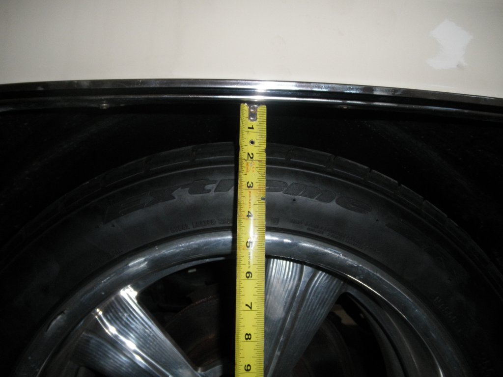

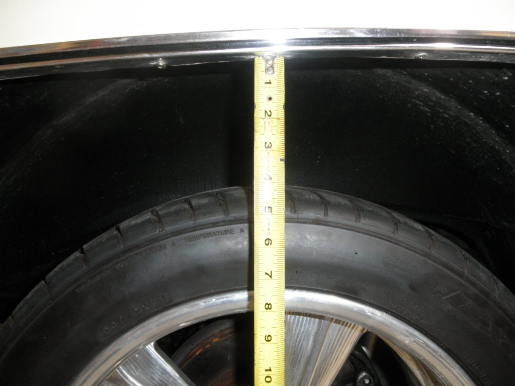

I finished the rebuild on the front suspension. We removed all four control arms and replaced all of the ball joints and the bushings with polyurethane bushings. The truck rides much better with the new pieces. The first picture shows the minimal fender clearance that we had with the old springs. They had approx 1 1/2 coils removed, and with the wheel/tire combo, the tires, which are 26" diameter, would rub on the fender if you hit even a small bump while turning. Not good for a driver. We replaced the front springs with new OEM small block spec springs. That resulted in the clearance shown in the 2nd picture. That was way too much. The stance wasn't right with the front 2+" taller than the rear.

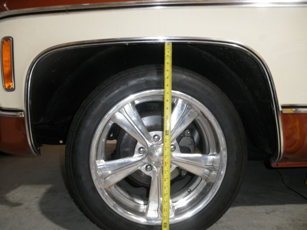

We cut the bottom end of the spring by 3/4 of a coil and took about 2" off of the top coil so that it would fit into the saddle in the frame. The ride height has settled about 1/4" after driving for a few miles.
To get back to the origin of this thread, on the stock spring, cutting the coil yields about 2" per coil.
