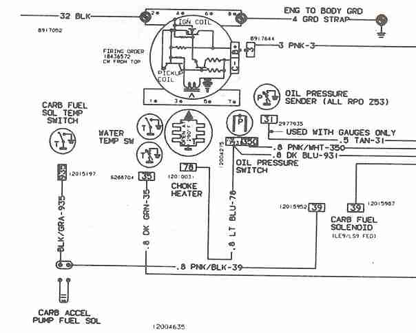

I have totally bypassed the oil pressure switch and simply send power to the carb choke heater. Works great. On the V8's I believe it is the PNK/WHT, not sure about the wire for the 4.3.
This is pretty much what i want to do for now. But where does this pink/wht wire start?

The PNK/WHT wire is energized to 12 VDC when the ignition key is in the ON position. It physically protrudes out of the firewall and is one of the wires terminated at the oil pressure switch connector.
My current truck is an 83 and has factory 305.
i'm thinking the circuit on the fuse panel that says "choke" is probably where i need to be looking?
Probably, but easy way to find out is use a test light, with the key off it shouldn't light up, turn the key on and it should light up..
It sounds like someone may have chopped out some of your wiring. Yes, the .8 PNK/WHT 350 conductor terminates on the fuse block at the "choke" fuse.
