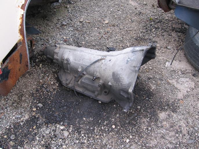

4l80

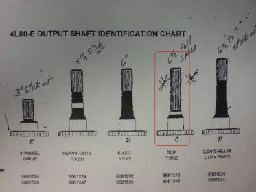

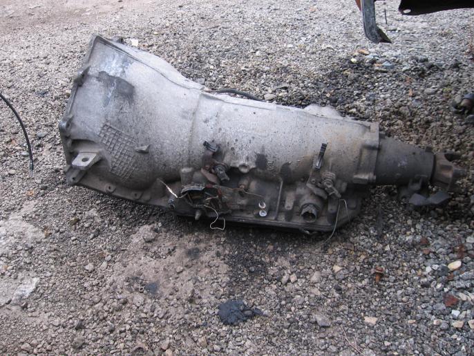

Yeah, looks like a 4l80. Can't tell if it's the "E" version, or electronically shifted, looks like it might be with that electric box on the shift linkage, but I might be wrong. If it is the "E" version, it will need to have a shift programing setup, unless you convert it to full manual. Also, I think your burban is 4x4, and this is a 2wd version. You will need a different tailshaft, and adapter for the transfer case. VERY heavy duty, and Over drive equiped.
Well it's 50 bucks plus a 20 dolla core if I want to grab it for a project trans and backup for mine. Didn't know if it would be worth it or not.
i would by it and use it as a core for my tranny
http://www.maddogtransmissions.com/category_s/26.htm
a core charge for that tranny is around 250 bucks
but that 2 wheel drive 4l80 would not be a bolt in to your sub transfer case would need to be adapted to it
Either from a 3/4 ton or a 1/2 ton burb with a manual trans or t-400.
