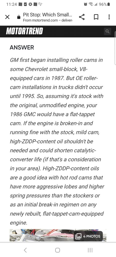

Okay going after market roller is going to be 750. and up there maybe Chinese kits cheaper but I wouldn't use one. According to motor trend GM cars got roller cams in 1987 trucks didn't get them until 95. Read the pic.
