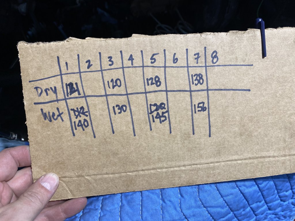

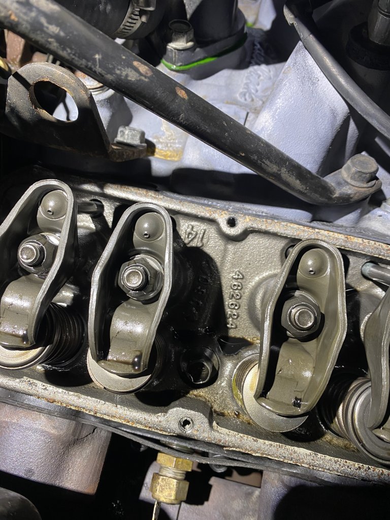

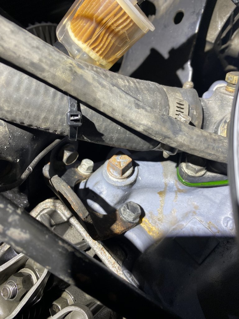

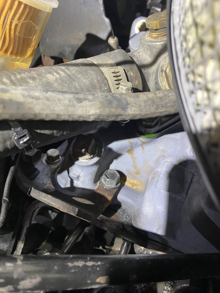

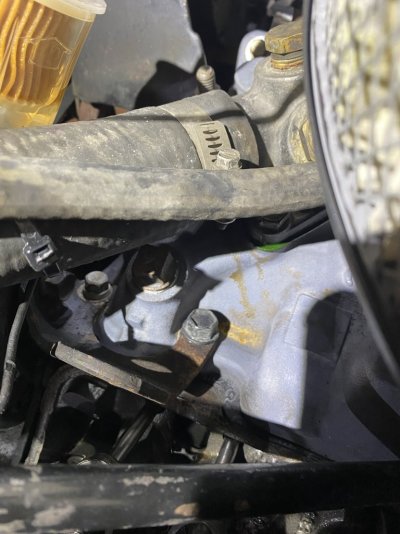

Here is what I got after doing my first compression test. It looks pretty good to me, correct me of I’m wrong. So, rings and valves seem to be OK if I understand correctly. I am now leaning toward an intake gasket leak. This motor came with no intake and I installed one. I got a little aggressive in tightening the 2nd bolt back from the front, driver side and stripped it when I was installing it. That bolt is smack dab above cylinder #1 where I’ve been having my issues. I drove it for a few weeks with that bolt messed up, not understanding the apparent significance. I knew it felt funny when it happened and that it wasn’t very tight but didn’t realize how big a deal that was. It’s never run very well since I installed the engine. I’ve messed with timing over and over, springs in the carb, choke settings, fuel regulator, etc etc. After recognizing that I was having a fouling issue I was tightening valve cover bolts, exhaust manifold bolts etc and checking over everything and I was able to clean the threads with a thread chaser on that messed up intake bolt hole and used a slightly longer bolt and was able to get it ‘tight’. I’m wondering if I messed the intake gasket up and that’s been my issue all along.

We're you holding the throttle wide open during all tests?
10,170
19,660
We're you holding the throttle wide open during your tests? Why didn't you check all cylinders? Wasn't your problem on 1 and 3? Look at those numbers both are lowest. I'd like to see how they compare to your other cylinders.
10,170
19,660
I'm leaning towards @fast 99 s post,post 4 I suspect your engine needs rings

Those a relatively easy intakes to pull however it would be nice to know for sure the intake gasket is suspect. It's no fun to tear something down and not find anything.
Appears it is somewhat apart already so might be easier to pull it now. Other option is to get it running and check for a leak.
If you don't know how to diagnose an intake leak on the bottom ask, I can explain it.
