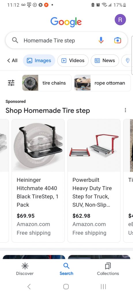

I don't have a pic of mine handy but will try to find a pic so you'll know what I'm talking about. Slip over the tire and working under the hood is much easier.
Very cool, that probably won’t fit a 12.50x37 but I’m sure I could make one.
10,170
19,660
I'll bet they make them that big,but I'd just make one.

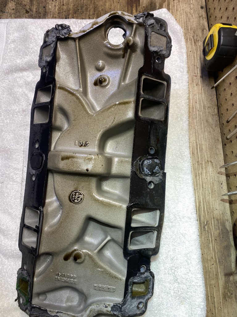

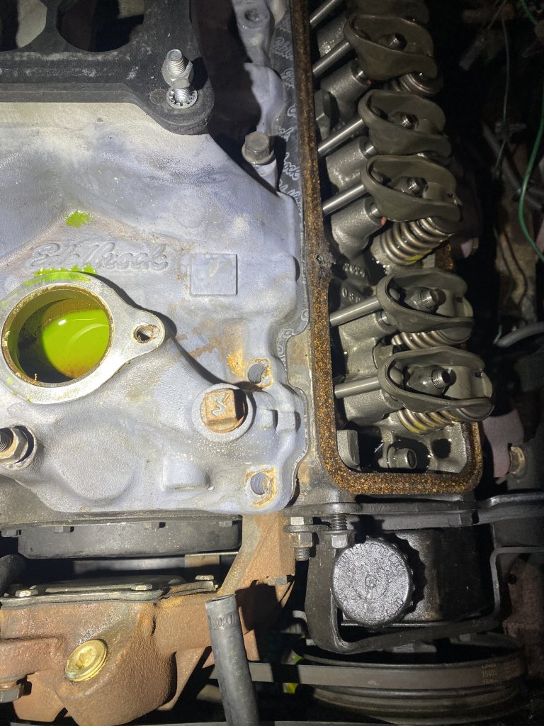

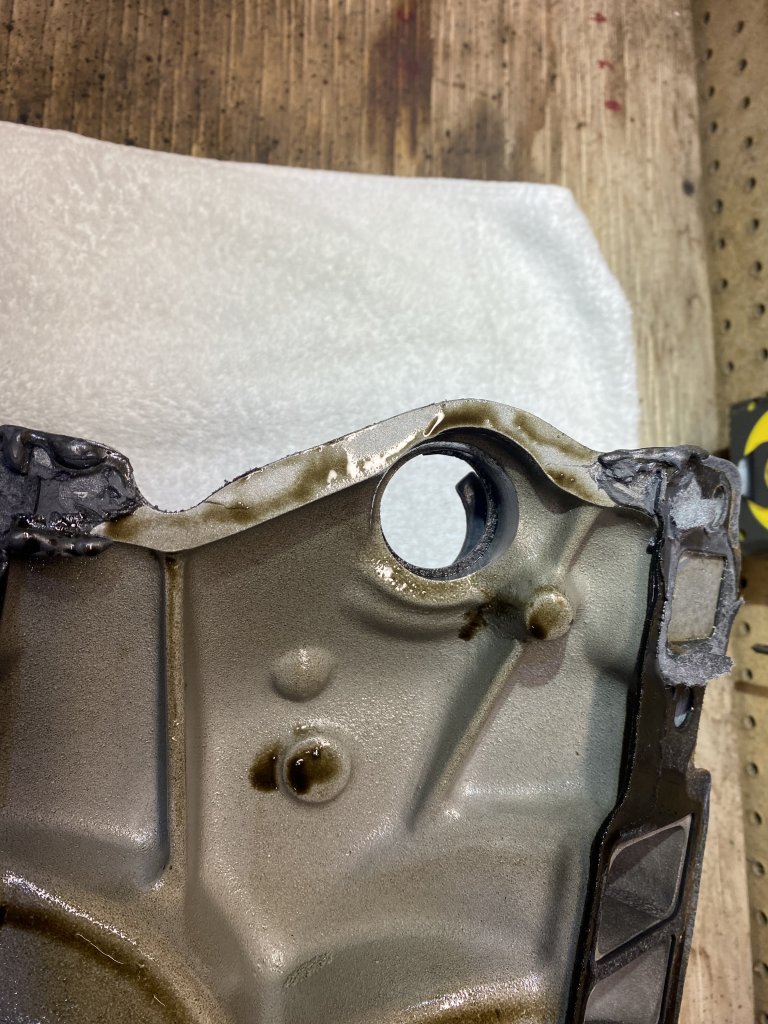

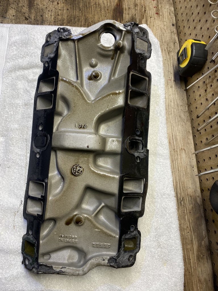

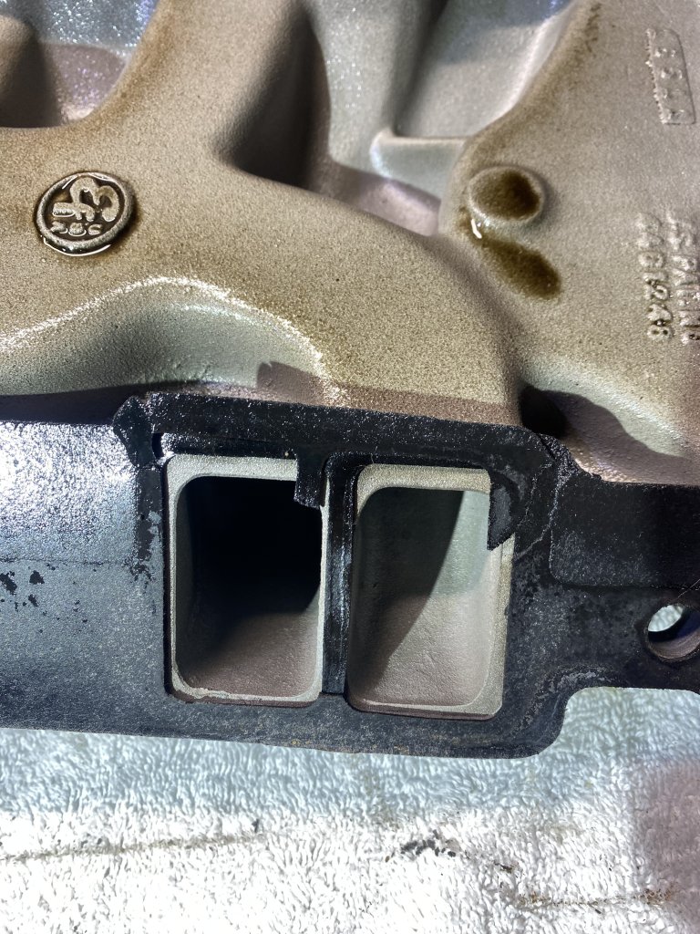

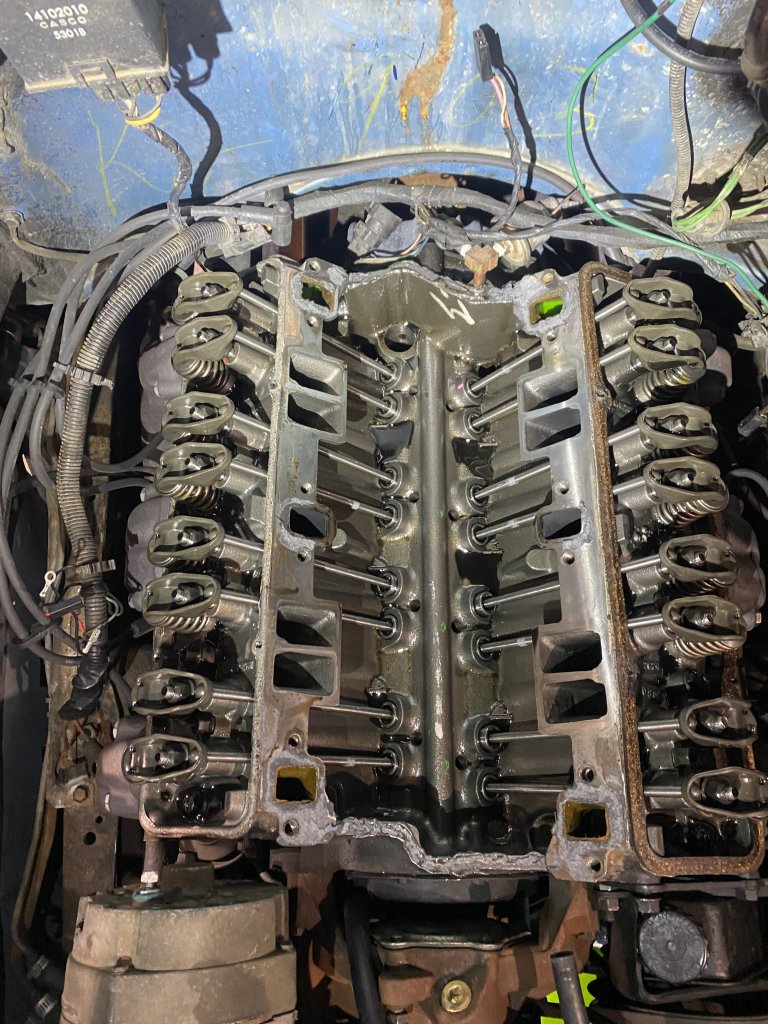

I was finally able to get the top of the motor removed. Here are some pics. I noticed a couple of places where the vacuum leak could be coming from: - intake bolts above cylinder 1 didn’t have washers and show some rust marks, the distributor gasket had a break in it, the intake gasket had a spot where it was broken. As you see the photos, does anything else look messed up?

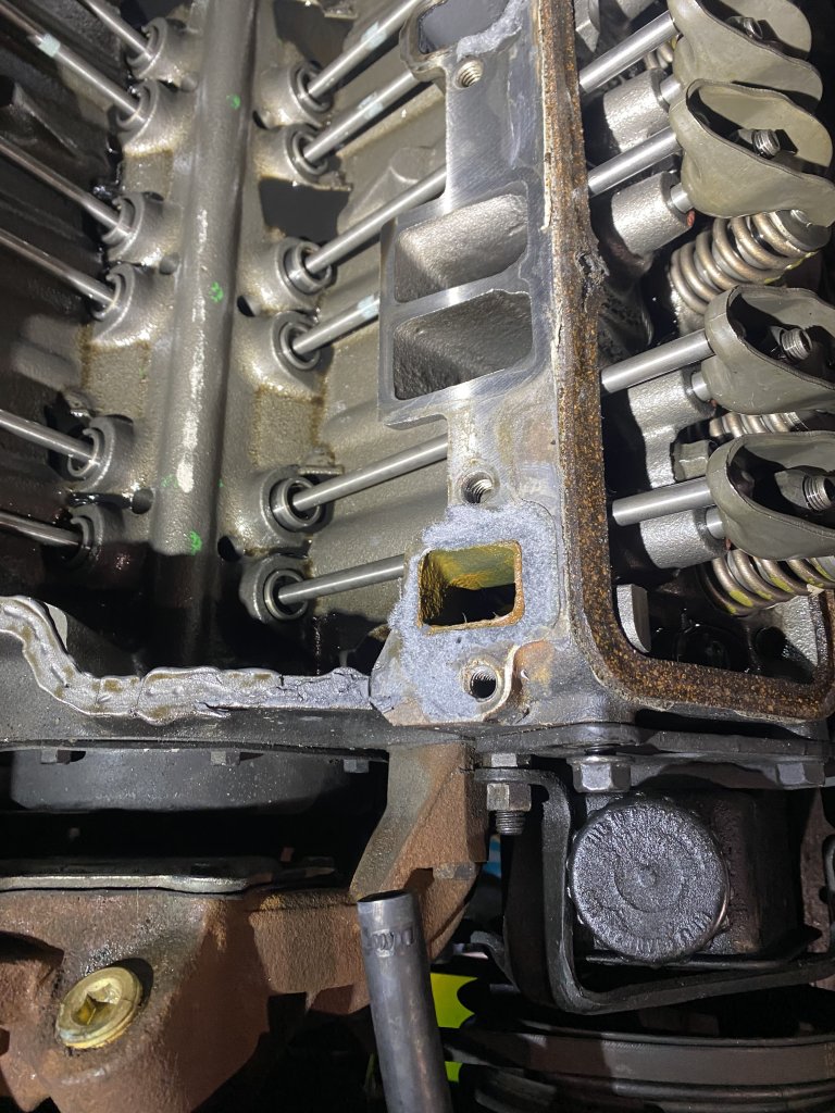

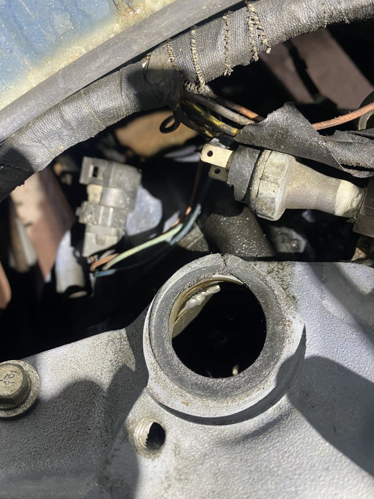

I was finally able to get the top of the motor removed. Here are some pics. I noticed a couple of places where the vacuum leak could be coming from: - head bolts above cylinder 1 didn’t have washers and show some rust marks, the distributor gasket had a break in it, the head gasket had a spot where it was broken. As you see the photos, does anything else look messed up?
