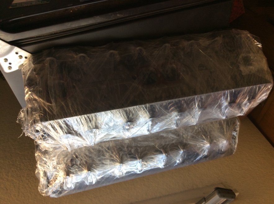

hopped up L31 waiting for a hot 400
heads

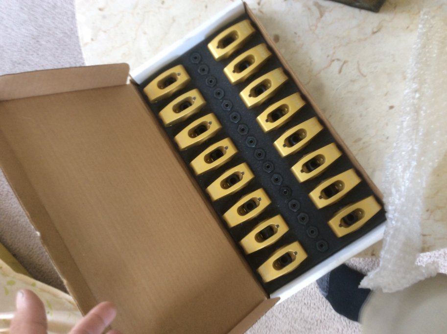

roller rockers
rollers

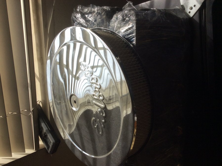

air cleaner on the heads

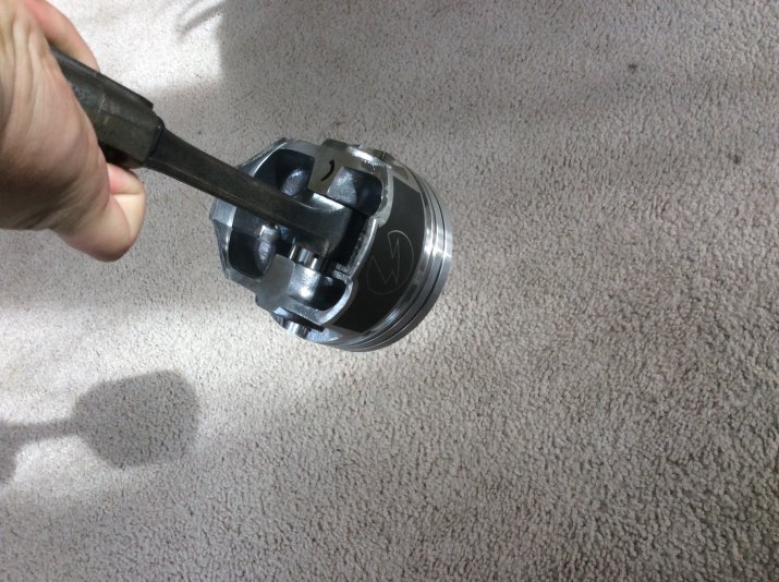

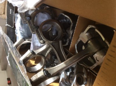

Pistons+Rods

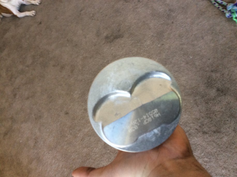

pistons rods again

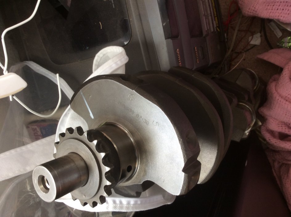

crank

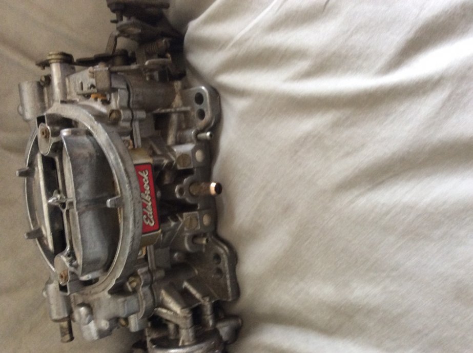

Carb

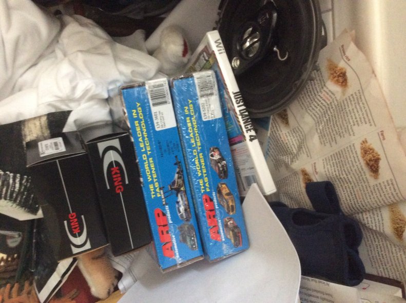

bolts and bearings

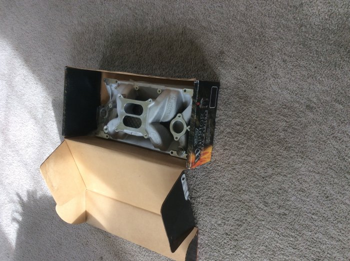

intake manifold
