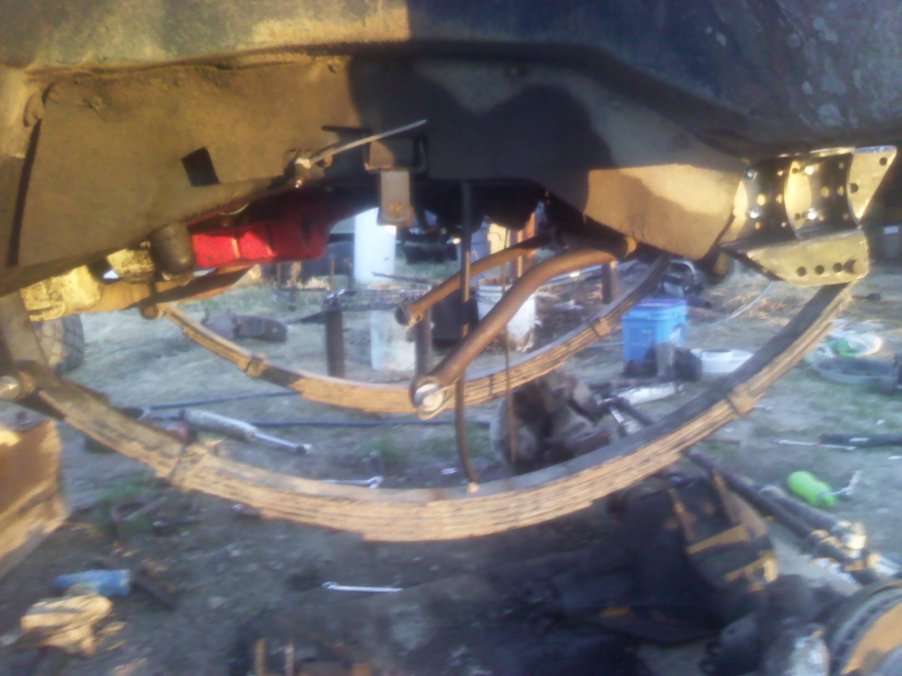

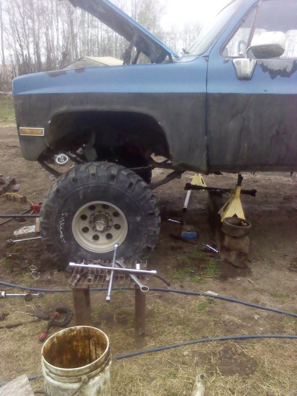

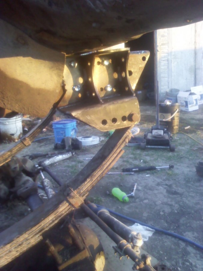

i just installed the 10 lifted 52s up front and am doing the cross over and welding the front well i am at it. can any one point me in the right direction for a front drive shaft. i have a wrecked 96 2500 looks like that drive shaft will work.
Chuck
Oct 4, 2013
156
Grande prairie
Chuck
K30 crew cab
6.2
heres pics

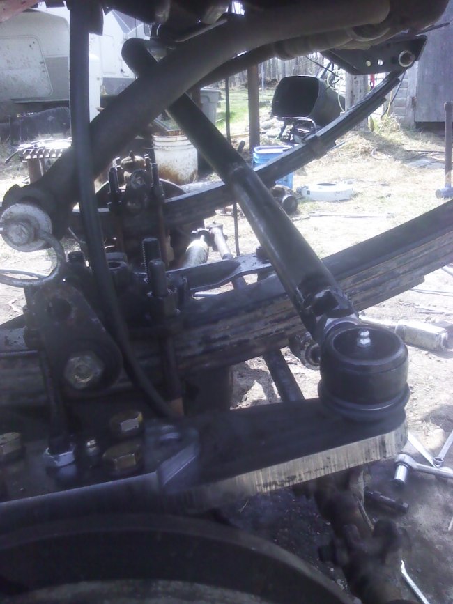

cross over
i made the cross over linkage and put it all together

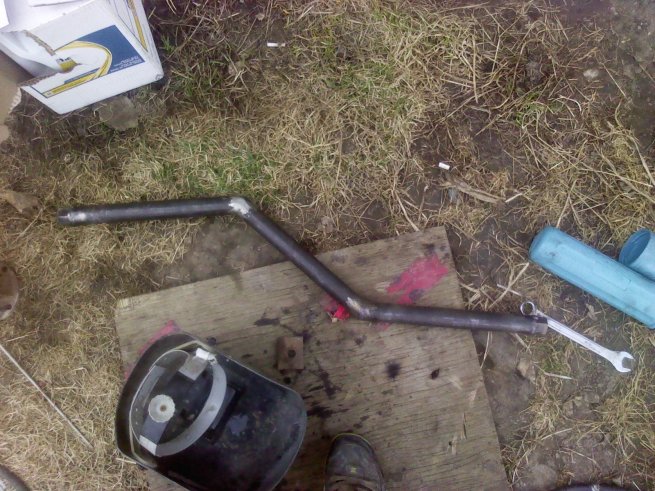

Front drive shaft I made
