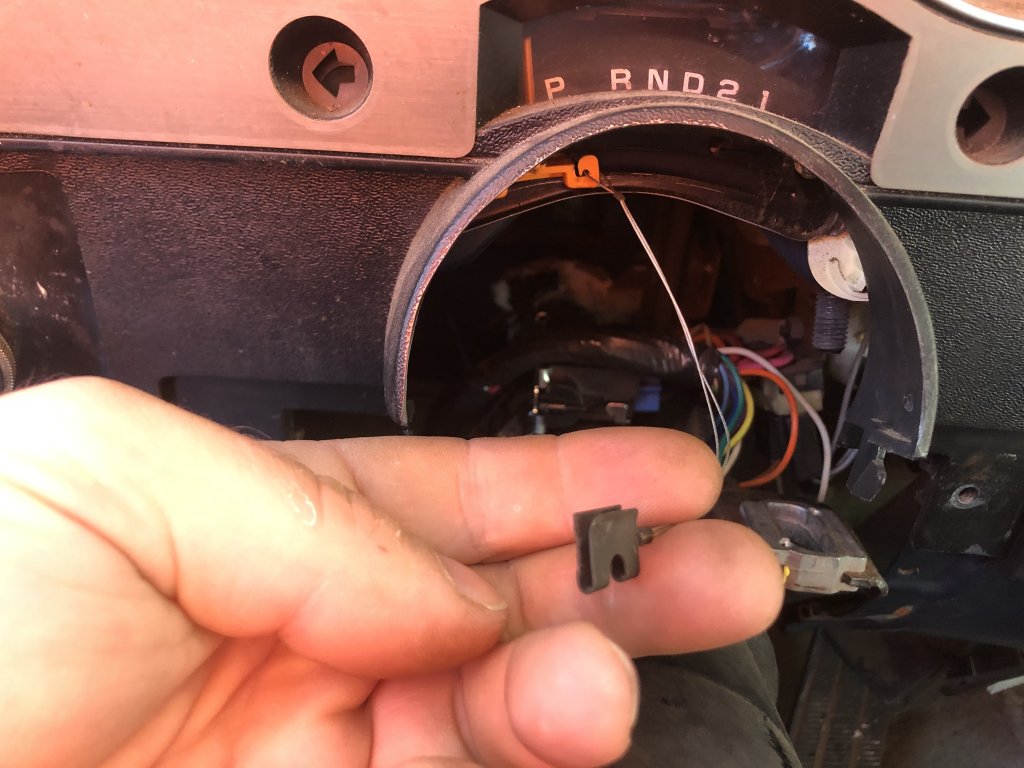

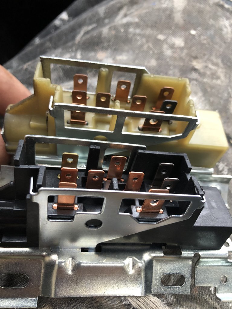

I installed a new ignition starter switch now I’m having a time figuring out where the gear selecter tie goes

Socket sizes used 5/8 on steering column 5/16 and 10 mm on ignition switch took me all day u gotta keep Foward pressure wen installing new ignition switch , eliminate the play towards yourself by pushing foward then tighten bolts

Not sure how this tie is supposed to be hooked up . Without the tie hooked up the orange selector won’t move thanks
There is a tab on the column that moves when you move the shifter. I don't have a pic.
I fixed the shifter bro.... But it still died on me after 10 min after couple stop lights , luckily was able to get it going again... I wonder how difficult of a job to rip out the wires off the starter and get new ones but for the life of me i cant see where they travel to.

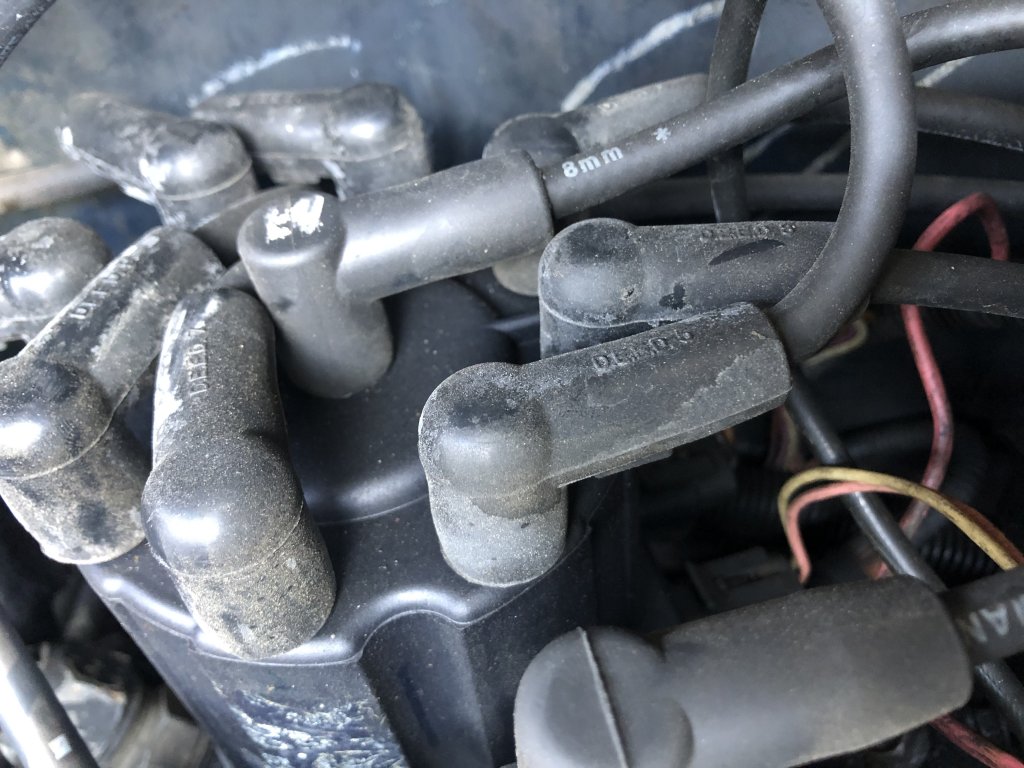

Have you tested the ignition coil. A coil will get hot and fail,then cool and start working again.next time it dies you need to immediately check for 12v at the distributor. If it dies and you have 12v there.we need to test the distributor components.

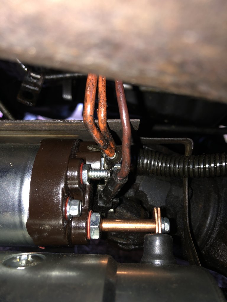

Ok just got the starter down and removed the shroud . Going to tighten nuts... I wonder how to test the wires ONLY for I suspect conduction may be intermittent on one or more of these wires.

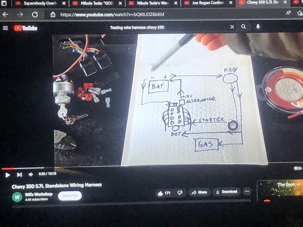

Ok a chart

I’m thinking that I have an intermittent open circuit.
The chart I posted seems incorrect be cause battery hot terminal seems to go to the starter and the alternator hot terminal

That is correct. There also should be a wire going to the distribution block on the firewall.

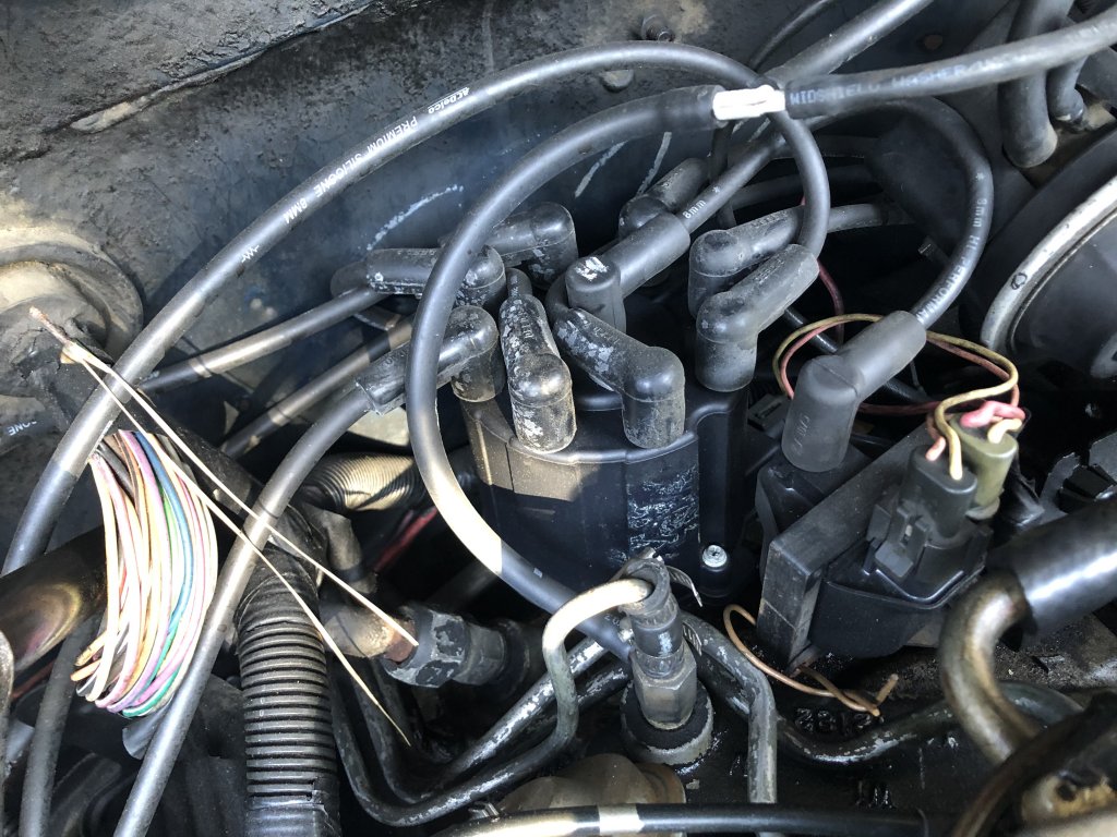

Sorry didn't read close enough,you have tbi with a divorced coil you to check for spark and, 12v to the pink wire A.S.A.P after it dies. If it were mine this exactly how I would do it as soon as it died I spray carb cleaner down the tbi. And try to start it no start? We know it's probably not a fuel problem. I'd check for spark to the coil wire,no spark see if the coil has power coil has power,we've isolated the problem to the distributor or coil. No power to the coil we have a bad wire or switch. If you do the above we will be real close to knowing what's wrong.
I’m able to start it up after it dies
