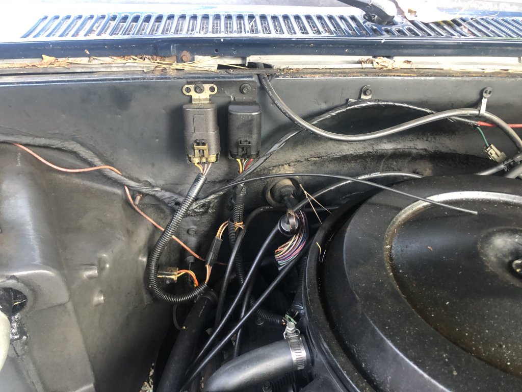

Any idea wich one is the pump relay

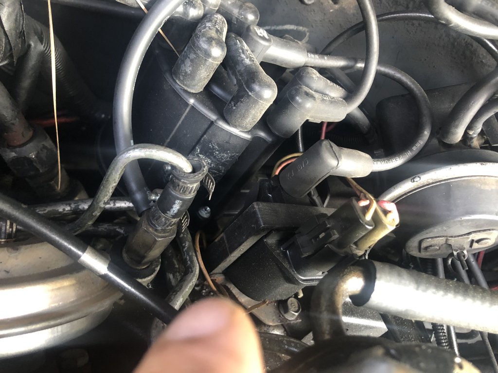

I have a peice of coat hanger holding the ignition coil in place missing nut n bolt on one side, the coil is a year old. ... could the coat hanger wire be doing something “odd” to the function of the coil?

do u think i should just buy another coil . Or can i test it?

Trying not to be rude, so don't take it that way, but based on the questions you are asking it would be easier just to take it to someone.

Ignition coil and ignition control module aren't the same thing. Dad used to say an internal combustion engine only needs fuel and fire to run. Solid advice but the newer vehicles go, more elements are in control of both sides of that basic analogy. I'm all for someone learning more about everything, but if this is a mission-critical vehicle (i.e. a daily driver for work) you may want a mechanic to look at it.

First thing I'd say is add an auto ranging multi meter and a year/ model specific repair manual to your tool collection. It'll have full details to identify and test components, like your fuel pump relay, ignition coil, ignition module, etc. To suddenly shut off like that implies ignition/ electrical so I think you're on the right track. Wish I could be more help but I'm at work, just checking now and then. Also I'm mostly a carb guy, not really familiar with factory fuel injection systems on these trucks.
