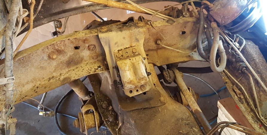

I need some education on motor mounts! I have no experience with small block (or any GM engine for that matter) mounts.
This is what I discovered when I pulled the engine from the 79 C1500. Seeing only 3 bolt holes on the clam shells filled definitely threw me off. Is this the way it's supposed to be? :shrug:
Do the frame brackets look right / is there supposed to be that extra hole at the bottom edge?
Thanks for the insight!

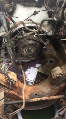

Looks similar to my '87 three bolts holding the mounts to the brace and four holding the brace to crossmember and frame.

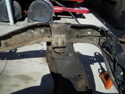

My 74 is the same way..

yes that is how it's supposed to be. highdesertranger
