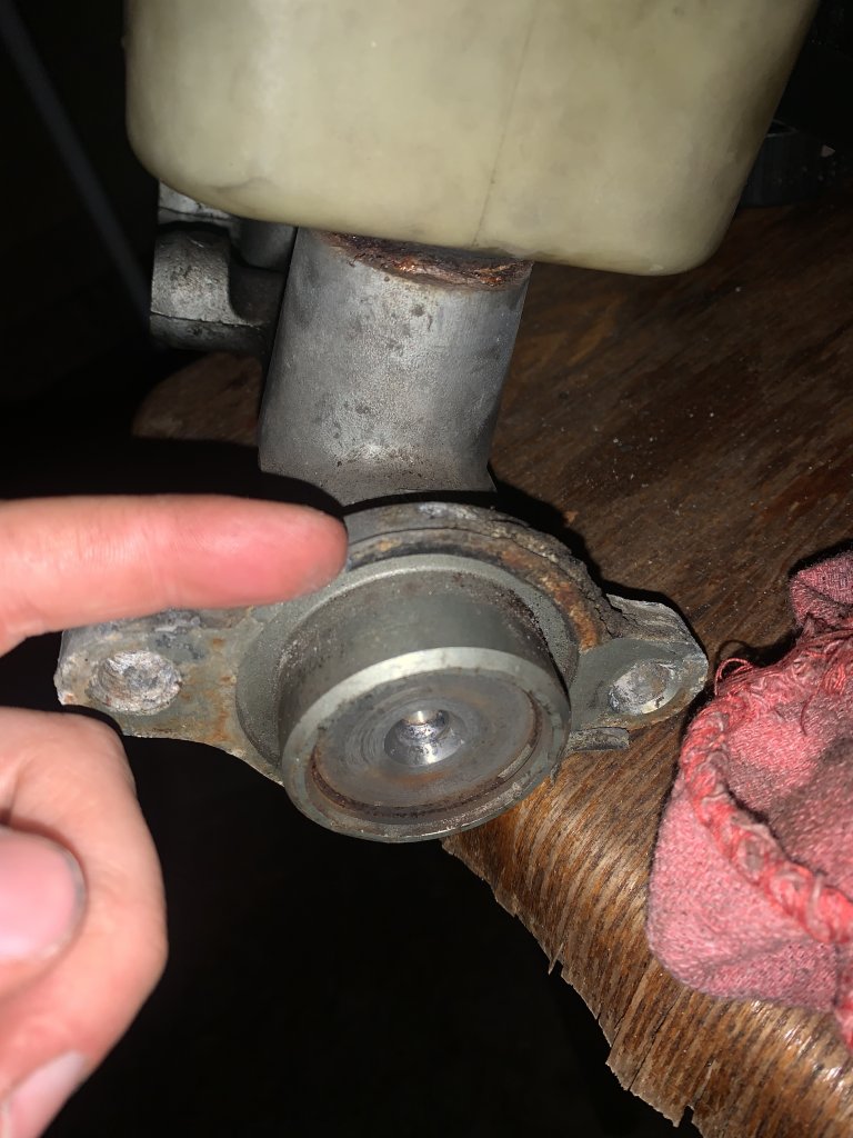

Ordered new master cyl and brake booster, going thru the whole truck…. Previously was what seamed to be a paper gasket between the master and booster (in picture) first off, can’t find one online anywhere and second does it need it? They’re both sealed units so I would imagine not?

Nope. No gasket lol. Something makes me think a thermostat housing gasket would almost be perfect size for it.
