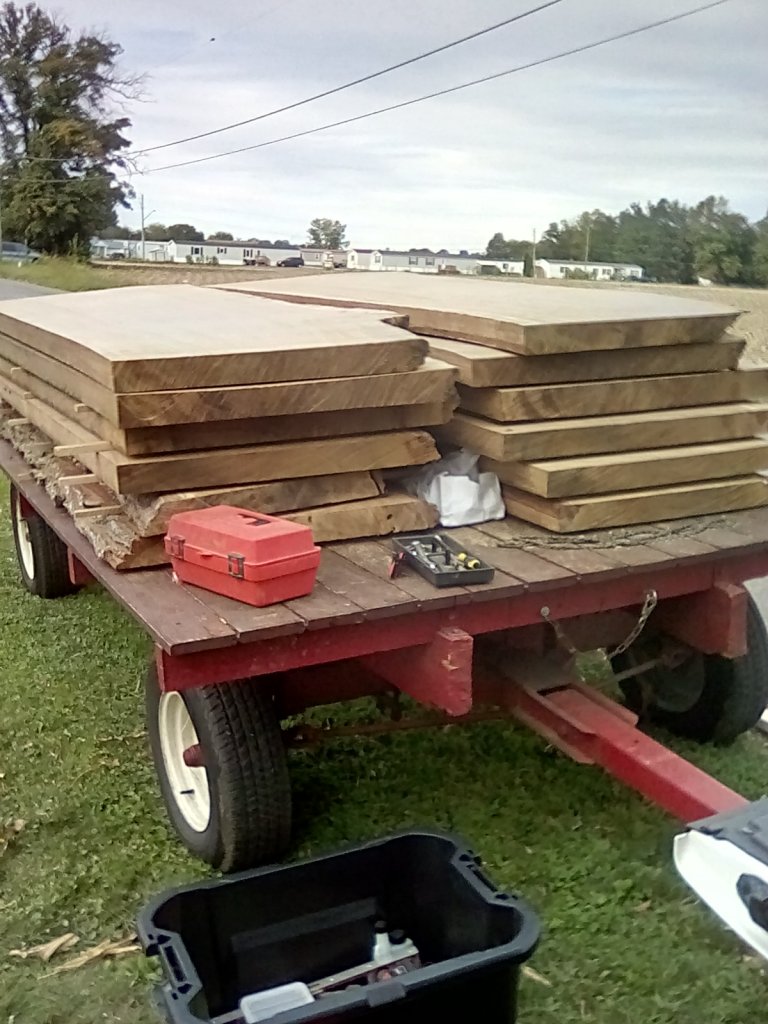

If you lived closer I'd mill whatever hardwood you wanted. It's my side operation soon to be full time when I retire.
