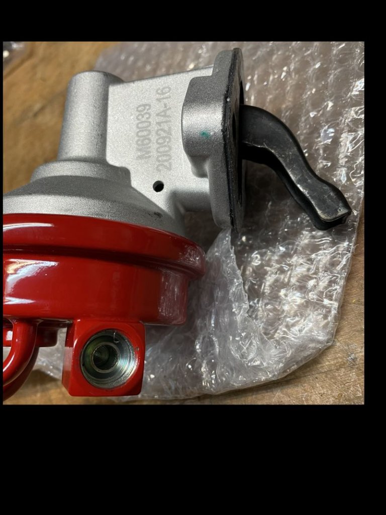

Hi All, new to site
i have owned this since 1986, just about replaced every nut and bolt in the old doll
fuel lines are getting bad from the ethanol, so might as well replace the pump, it is at least 20yrs old
i have installed carter fuel pumps on my 1983 gm k1500 350 sbc may times over the years they work perfect
however my new pump does not have the red spring under the arm, is this part of a redesign?
and can i just take the red spring from the old pump and put it in the new one?

contacted carter, and was told it is a redesign, not sure if it should be redesigned this late, not like it goes on new trucks
i will install it and see

I had lots of trouble with a supposedly redesigned new pump. Can't remember what brand they were however inside the opening on top of the arm a return spring wasn't there. After one short commute the arm would only return about 1/2 way. Truck was running out of fuel under load. After 2 of those tried an AC Delco. Spring was in that brand.
Pump you show is missing a different spring maybe it will be ok? If you have trouble try AC.
