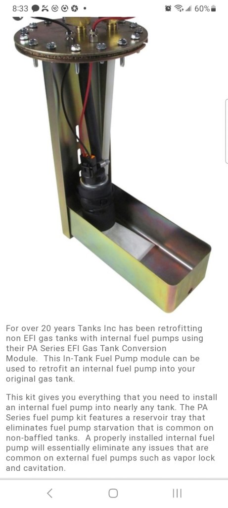

Hmm look at this,I think I could fab up a baffle arrangement like this. Click on the pic it's not all visible In the thumbnail.
