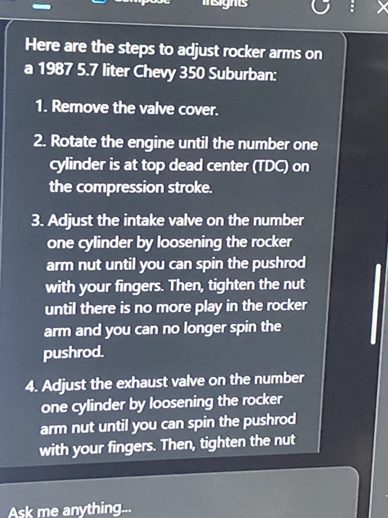

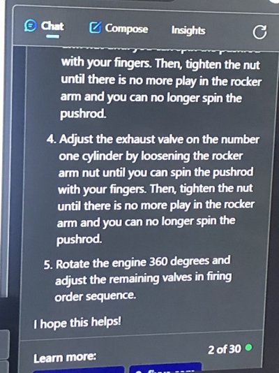

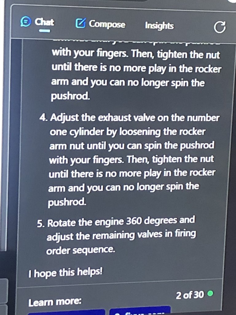

When adjusting a cylinder how do you know when the lifter is in correct max position before adjusting it?

Since 4,6,8 are bad how do I adjust the number 4 intake and exhaust?
