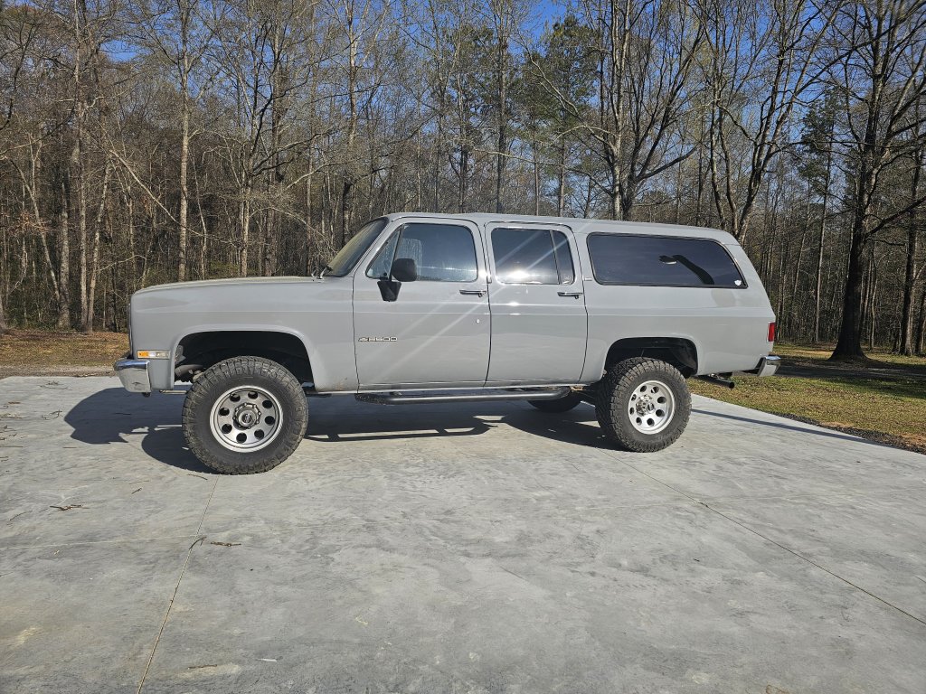

So, got a new to me '91 V2500. Originally a State vehicle from Alabama. Passed through a couple hands and then to me.
Mostly played with blazers in the past, and I've run into something I haven't before. Just had it repainted and since then the brake lights don't work. Parking, hazards and blinkers work fine. First thought was a fuse or the brake light switch. Replaced both. Still nothing on the brake lights. What else might I look for? BTW, has led tail lights.
