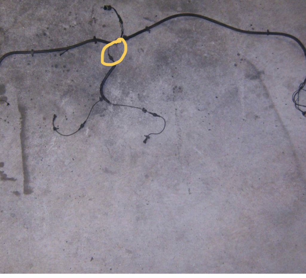

The wires are cut where I have circled so it doesn’t have the small split off for the license plate lights,, my lights work now except quads only one set at a time works, dash light’s also not working again
I have another thread just today ‘quad lights not working now’ maybe i should have put it here instead of another thread lol

Guess it would help if I attached the pic

I have added an old stock radio like an original (no radio or speakers in when I got it), same wire colors and all, speakers are regular (2 small dash and 2 ovals in the back). I put new side marker lights in and spliced them in the correct wires on the parking lights. I put in new license plate lights and that’s spliced correctly (attached is an example pic circled of where my back light harness was cut of so it doesn’t have the two plugs for license plate lights). Grounds are all cleaned up, new battery, new headlight pull switch, new correct bulbs, new cigarette lighter thing, new door pins for interior lights. New relays in the fuse panel, everything is stock to keep it close to original.
