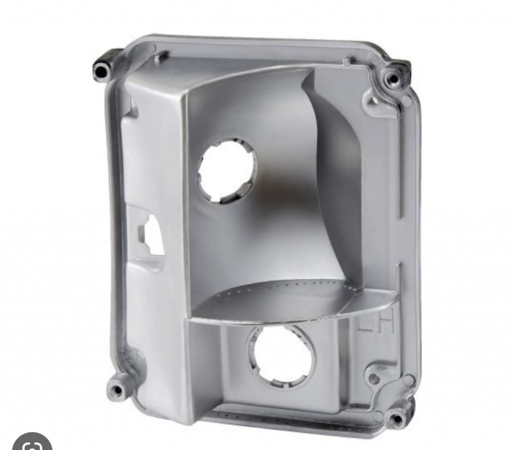

Thanks, I’ve been looking on here at other posts too and will check groundings, this pic attached is like the housing for my taillights, the left side, the top is running/brake/signal the bottom reverse and the smaller hole has the little bulb that signals with the regular bulb signal. It’s to the side so I’m guessing it’s so people can see the signal on the side since there’s no yellow maker lights on the side in the back like on older models, but my front has the yellow marker lights
I found some diagrams and someone else mentioned factory ground locations, hopefully I can come back here and say found the problem and it’s fixed

You'll get it fixed, what your doing is not likely hard, but it could be a bit time consuming depending on your skill level. Just remember to check for power, check the socket, check the ground.
That little bulb in the rear is a marker light it does not flash, just comes on with the running lights. I can double check that on my truck if you want.

You said you checked the instrument panel circuit board, so I guess you took the cluster out. Did you ensure the cluster ground was reconnected? It’s up under the dash and it will be either grounded to the parking brake mechanism or to a dedicated ground point up on the firewall. If disconnected it causes multiple weird lighting symptoms.
The lack of flashing for the front marker light is usually just due to a bad ground for the light housing. Clean up the eye in the end of the ground wire and send down to bare metal where it screw into the truck body. The other possibility is that a two terminal bulb (like the front park lights) is plugged into the socket in the wrong orientation.
