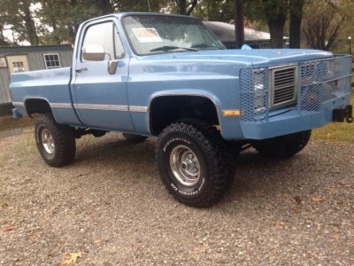

I bought a 86 k1500 about a month ago and the guy didn't know the lift size, I can't find anyway to find out what it is, pretty sure it's a rough country....maybe a 6inch? Has 35s on factory rims that don't rub with the winch bumper. It rides pretty rough, so Im about to purchase a set of ezride springs but don't know which size to buy since I'm not sure of the lift size. The front nose dives pretty hard and would like to get it more level if possible. Any help is appreciated!

Any pics?

Having trouble uploading from my phone right now

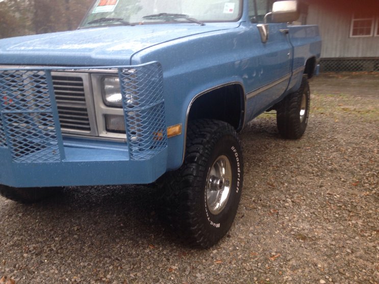

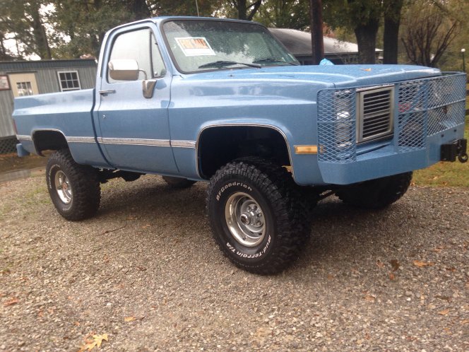

All I have for now

Holy cow that's a sweet bumper. If those are 35's, that's a 6" lift. Do you have lift springs in the back or blocks?

that looks like 6"
