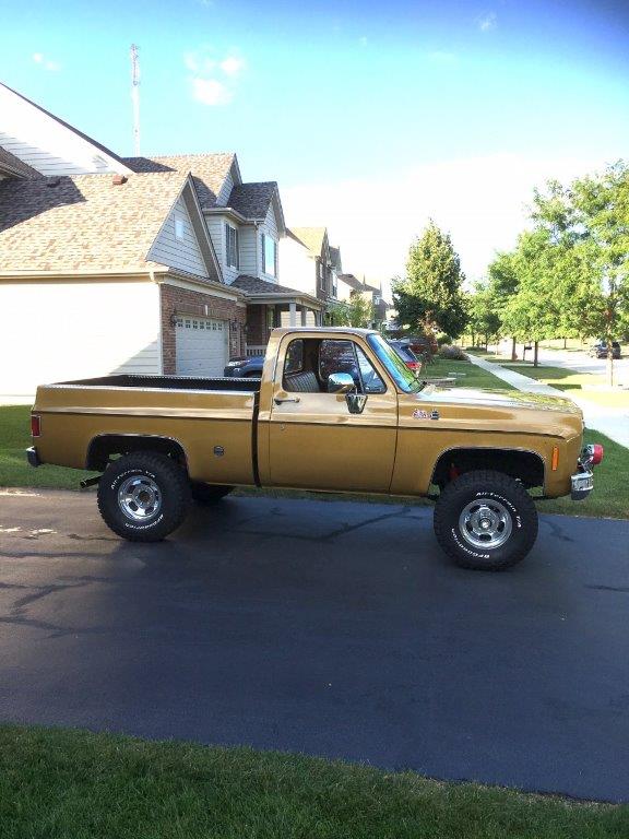

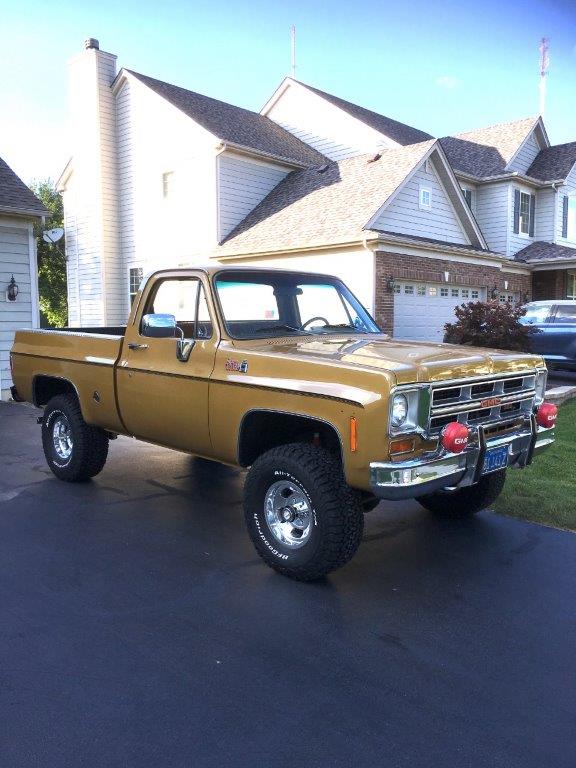

I went with a ProComp 2.5” lift and up two sizes on the tires (31” to a 33”) for 4.5” of overall lift. I don’t use mine for off road and I wanted it to still fit in a standard height garage opening. It rides fine on pavement but I later added a ProComp double shock stabilizer to the front because it felt just a little loose.
Pics were right after lift, wheels/tires were installed (around 4yrs ago). The front sat a little high at first with the new springs that came in the kit. Over time the have settled and the truck sits level now.

I really like the stance on that one plus it would be a bonus if it fit in my garage for sure
