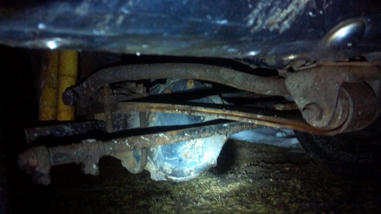

Here's what the front leaves look like.. opinions?

Mmkay, where can i get a good set of cheap ones?

Im not sure what you budget is, but you can start on Summit or Four Wheel Parts....

hell just get a set of add a leafs itll level it up and not make the ride much harsher.

True, my thought was if the springs are toast all the bushings may be as well, inspect those too.
If so, it may be easier to do the springs.
