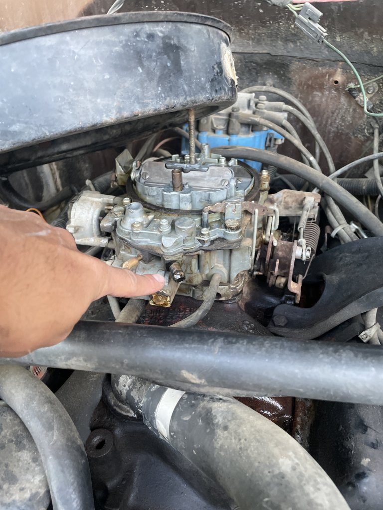

leaking gas through this hole -https://iscanner.com/sharing/45d88576

That's the bowl vent. Probably high fuel level caused by heavy float. Rebuild should fix it.
Nipple usually has a hose to the charcoal cannister or is plugged with vacuum cap.

https://iscanner.com/sharing/45d88576 -TruGrade Fuel / Fuel Pump from auto zone- last night it turned on fine and idled fine for about 30 min before i turned it off, this morning i turned it on and stayed on okay then i smelt gas and i saw it leaking a lot of gas.

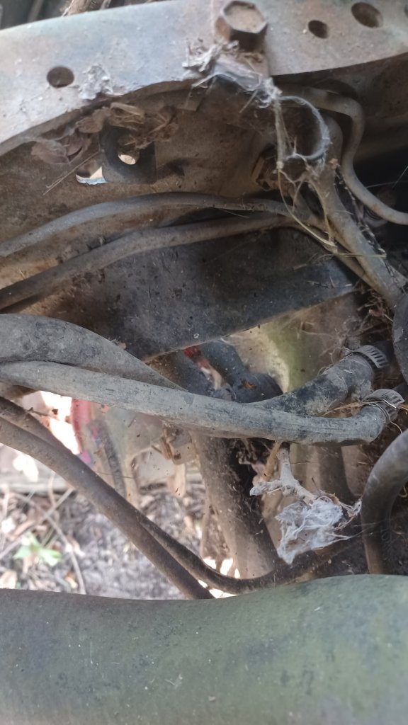

here’s was the old old and here’s the new one it has 2 hoses connected to it. and i turned it on right now it was on for about 1 min and then it started to spill through the hole again and i shut it off and it leaked quite a bit of gas when i turned it off same hole (btw) i don’t know much about these trucks it’s my first one and i’m having trouble
6,475
11,033
Look down by the frame where your supply hose is. Is there a steel 3/16 pipe that leads back to the tank? If it it has the vent tube running back to the tank put on a 3 line pump,so it can relieve fuel pressure back to the tank. If not check your fuel pressure, I'm going to guess it's too high and rises as the fuel expands blowing the needle and seat open. In which case it's going to be a game of musical fuel pumps,adding a deadhead regulator or adding a bypass. Personally I would add a bypass.

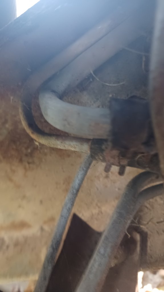

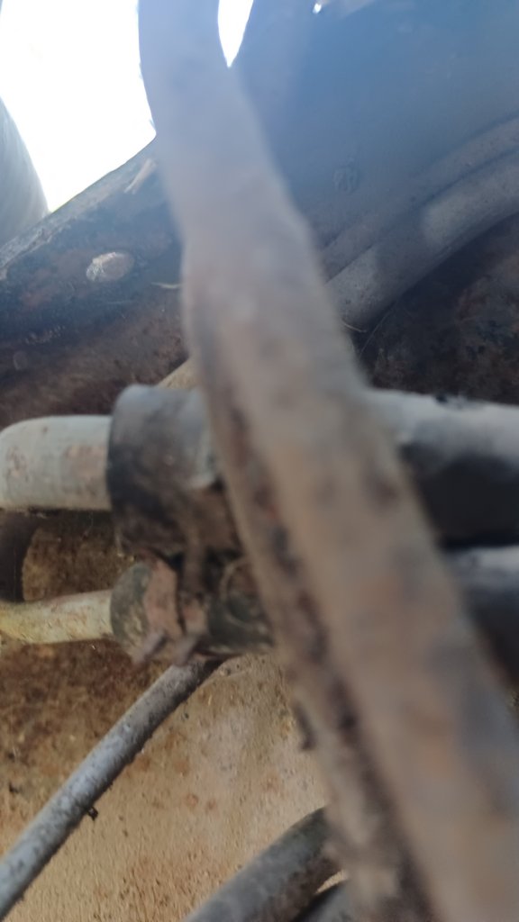

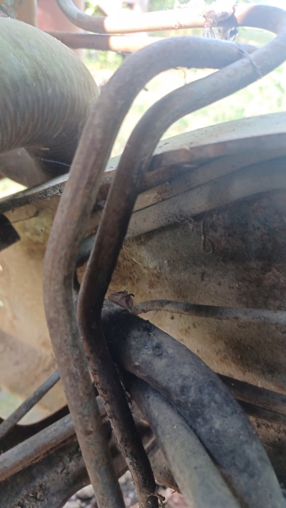

Okay from post 10. I thought you had determined you needed a 3 line. I'm going to show you a pic of both hoses connected at the pump,same hoses connected at the frame side,and the 2 lines running down the frame. You need to see if you have the small line on the frame. Pic 1 pump side pic 2 frame side pic 3 and 4 tunes on the frame.
