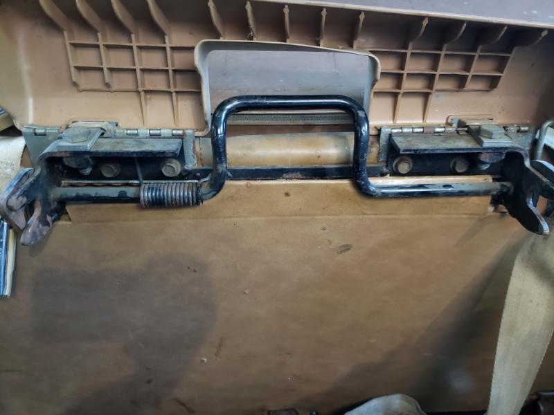

So the next question is, what years is the truck? You say '77 but the fold down seats didn't start till '78. Post a picture of the rear floor, I'm wondering if someone "added" the fold down seat

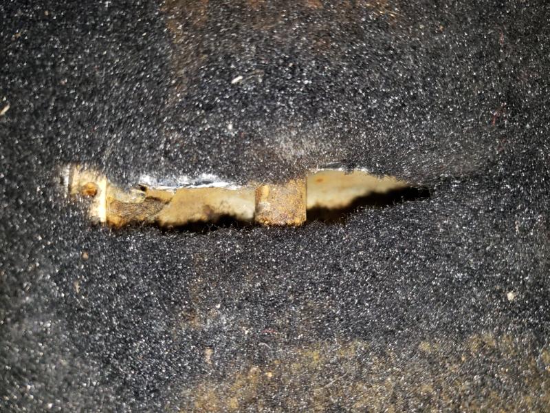

Well ****. Thanks for suggesting pics, because you single handedly solved the problem. The new carpet mostly obscures the strikers. I had previously checked the right side striker to see if it was adjustable, which it is not. So to take the pictures, I pulled the carpet back enough to get pics of both strikers ....

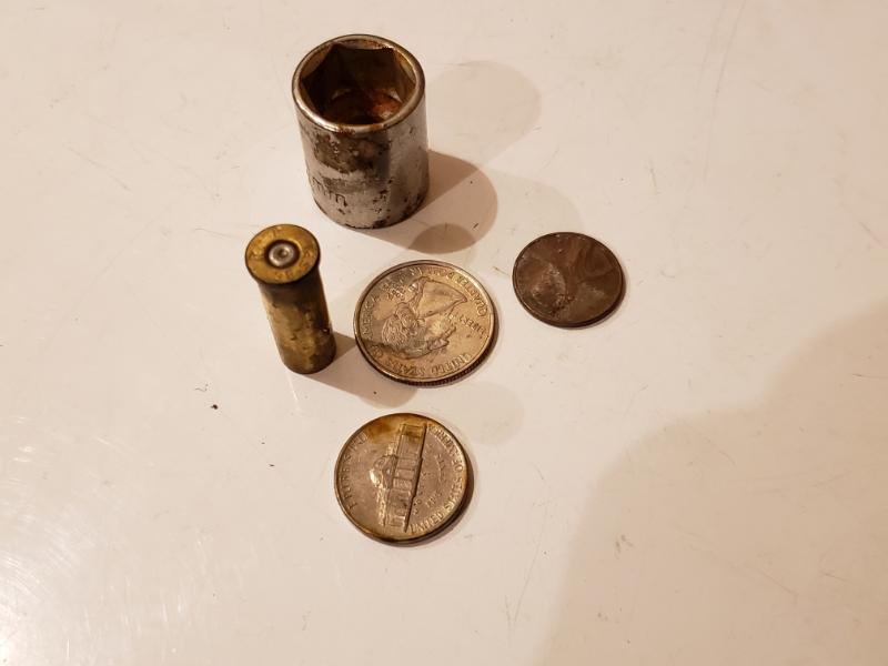

Guess what I found under the left striker...

So is your rig a '77? If in fact it is, someone installed the '78 and later rear seat. You may want to pull up the carpet and check on the quality of work. Also, it shouldn't just be some slits in the carpet. There should be a larger opening in the carpet, along with a chrome trim bezel. The larger opening let's you see if objects are down in the striker pockets.

I was slamming that seat down pretty hard several times. I'm surprised the coins and stuff didn't bounce around and rearrange themselves to allow the seat would close. But I'm sure glad that was just a spent bullet casing and not a live round. Slam slam slam BOOM! That would wake me up better than coffee. A live round would probably not fire under these conditions, but I would not want to test that theory!

10mm socket?
That's a good question. I think its probably closer to a 13mm based on the size and weight, but I did not check that actual size. I was more curious about the spent cartridge. Its not a .22 and its not a large caliber either. No where close to a rifle round, but if memory serves its longer and narrower than a 9mm. Never seen that size round before. So... I guess I will go check and let ya know.
