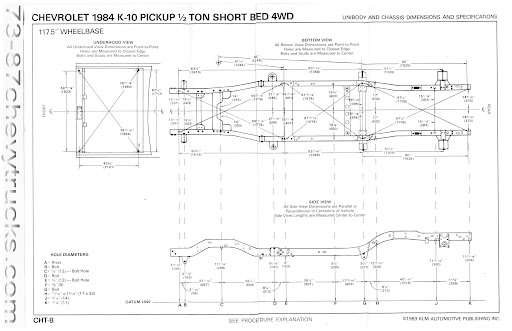

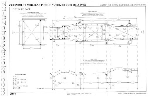

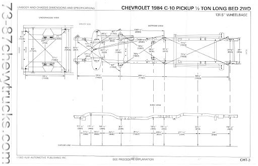

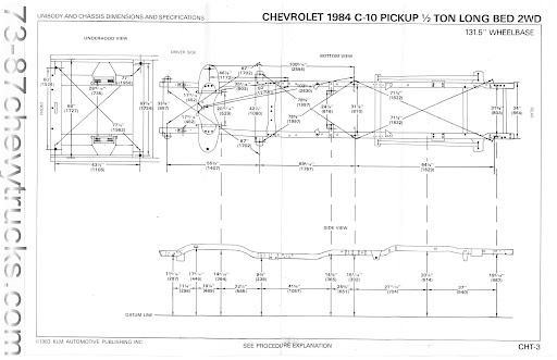

I know its been done before but i dont think its easy google search k10 frame specs (use image search) ive seen diagrams online somewhere with measurements they are chevys factory diagrams do the same for the c10 and compare.
i did this recently for the rear frame (i had to add a section) but ironically its the only part of the diagrams i cant read are the rear sections so i cant figure out where to drill bumper holes or how long the frame is saposed to be
found these right off but the resolution sucks cant read the dimensions on my phone dunno if this will help you or not
