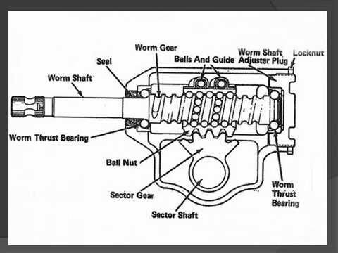

Can the sound be repeated while the vehicle is not in motion? If so, I would make the noise repeatedly while someone inspects the front end, preferably with a mechanics stethoscope or a long screwdriver. If the steering box is making popping noises after its properly adjusted, and properly secured to the frame, then it must be defective.
