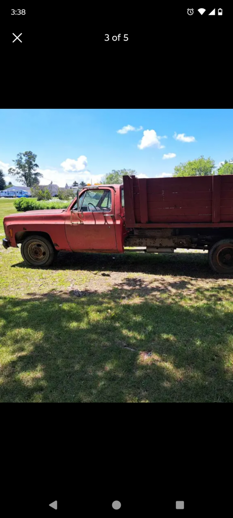

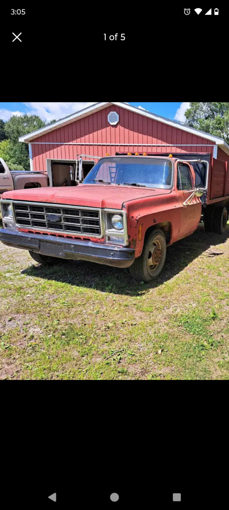

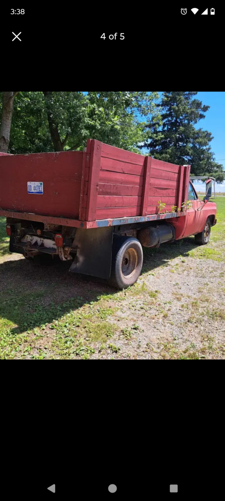

Hi my name is Justin I'm new to the forum thanks for having me here. Right now I am just looking for some advice I recently found a 1979 c30 dually manual trans with a dump bed Vortec block vortec heads carbureted intake HEI distributor with an Edelbrock and is solid and very clean by the way. The post that I found said that it had the top end redone but now has no power. So I drove over there with the car that he wants for the truck which is a 09 G6 I definitely want to trade cuz why not that's a great deal. The truck started great the carburetor and choke operated perfectly and idled fine a side of there's a bad misfire and smoke rolling into the cab that smelled like burnt oil. He told me that the guy he had working on it said that there was a cracked head so he went out and bought some vortec heads lifters push rods and roller rockers that the mechanic couldn't get them to fit right for whatever reason. so the guy bought another set of heads lifters pushrods and rockers which apparently worked but when he driving home couldn't get it over 50 and it didn't have enough power to make it over a overpass but didn't have that issue before hand and he doesn't know anything else about it besides it's leaking oil from the back of the intake where it should of been permatex. I didn't want to mess with anything trying to find out what's wrong at his house cuz I'm on a tether i was limited on my out time. So the advice I want to get is after checking the obvious plugs, wires, distributor timing what could be going wrong with it that would not make it okay to drive 30 mins home as I do not have a way to tow it. At that point I would be worried about mechanical I don't know what was touched or done correctly. I'm hoping it's something simple or even stupid like crossed spark wires. I want to get it back to go back through it for my peace of mind and to fix the problem but not at the risk of ruining it. Any advice would be great thank you.

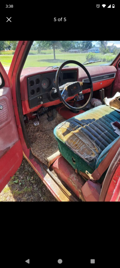

Could be anything from a fuel filter to a burnt valve. Gonna take some time to work thru it. I'd drive it around his place for 30 minutes and if it didn't stall I'd go for it. I love the floor mat!. I could curl up and take a nap on that bad boy. @Ricko1966 can give you some more detailed pointers to look for.

That's a good idea to drive it around first I did plan on that I'm just worried about hurting something...idk why they bought lifters and push rods and rockers I'm not sure I'm not even sure if they were new or not. I did however look at the old lifters and the wear on them was minimum like there is no heavy scuffs or dings or dents I'm not even sure why they thought they had to replace all that stuff but that's what's got me concerned is either I'm not getting told the whole story or the guy that was doing the work shouldn't have been doing it but like I said I do really want the truck the G6 is a POS definitely worth a straight-up trade
