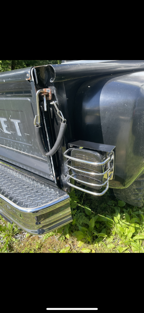

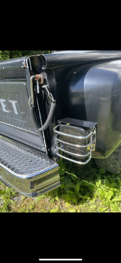

Wanted to protect my new LED’S nothing available! Has 3 post rectangular truck lights like a Jeep Wrangler so a bought Kentrol SS guards for a Jeep. Add 3” to top and side of mount, 1 1/4” to bottom of stock 1/8” thick mounting plate. Weld up and move 3 whole mount holes, cut grove for light wires depending on your light. Sounds like a lot really not, nice little project!!!

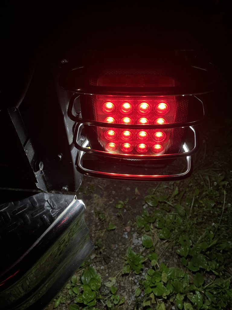

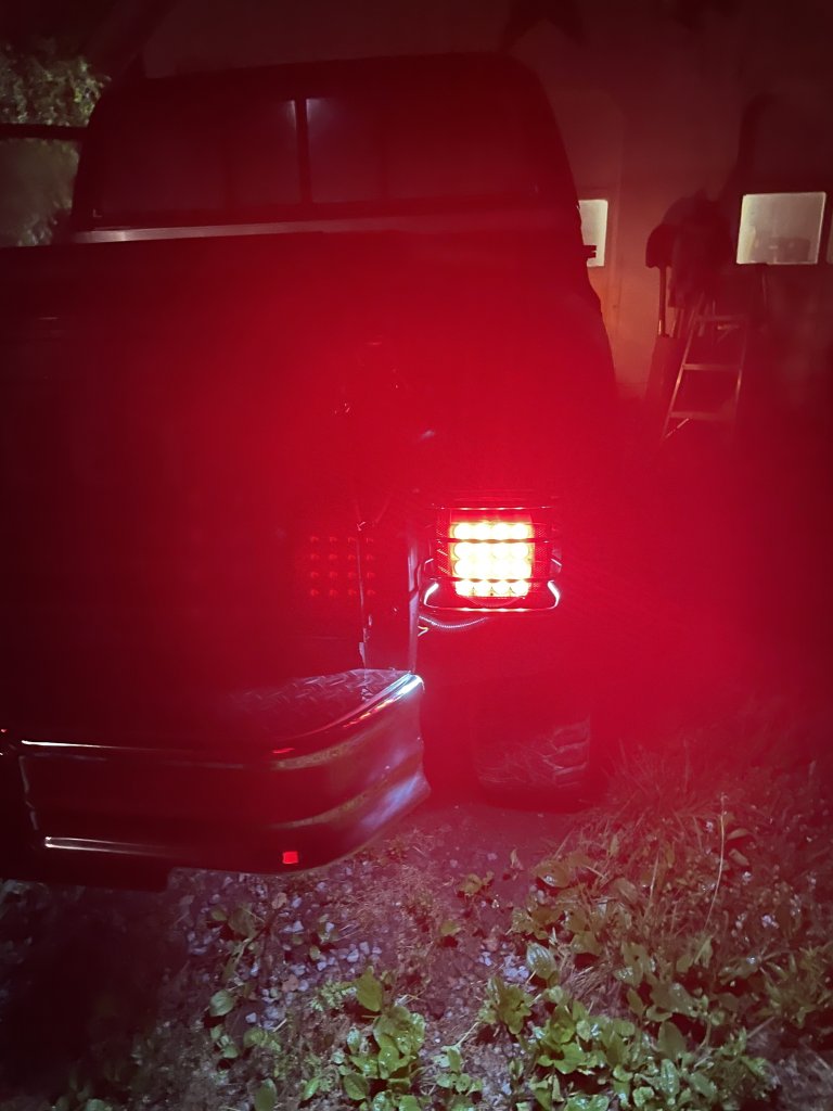

Thanks, lit with brake on and just running lights
