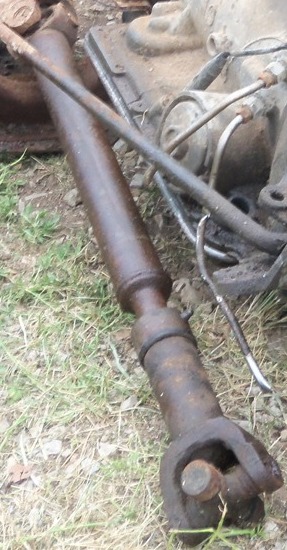

I have found a np203, and bought it.
the rear output is a fixed yoke, can you tell me how is the rear drive shaft on a K10 with np203 ?
47,928
11,189
That's actually the better style you'd want. Biggest advantage being, if you're out on the trail, and break your rear driveshaft or rear axle, you can pull your rear driveshaft, throw it in the back of the truck and rock on in 4Hi LOC with your front axle being your way back home or to the shop.
I can't seem to find a pic of one, but it's a splined 2 piece shaft so that one piece can slide on the splines of the other. Very similar to the front driveshafts but it doesn't have the double cardon joint.

ok, i was thinking it was a 2 "segments" shaft with a bearing bracket at about 50/60 cm of the TC and then a flange where the second part of the shaft?
something like that :
47,928
11,189
NO, not for a fixed yoke where the driveshaft actually bolts to the yoke.
It will look something similar to this where the slip is within the driveshaft itself.
