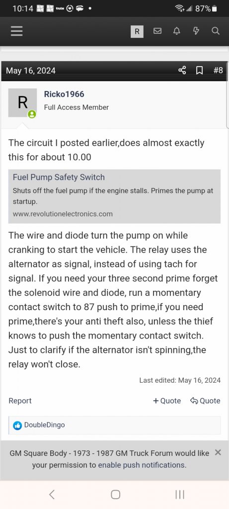

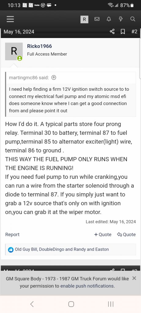

I wrote this for another member about a week ago,the text is screenshots in the thumbnail. If the diode part confuses you( no insult meant) I can write it using 2 relays one in crank position one in run position. Ans easy safe way to wire up an electric fuel pump.
