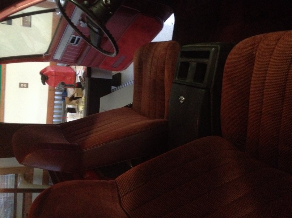

Alright, got bored today at work and read some old posts of interiors and got inspired. Came home and ripped out the bucket seats and console from a parts 91 suburban and overhead console. I still have some parts I'm gonna swipe from it yet but it's almost bare boned. Anyway here's some pics.

Damnit, it's sideways

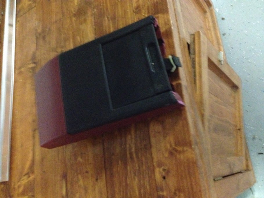

Another pic

Looks exactly like my '85. Took mine out of an older Blazer. Red high backs and red console. Like it a lot better than the bench. Good job.

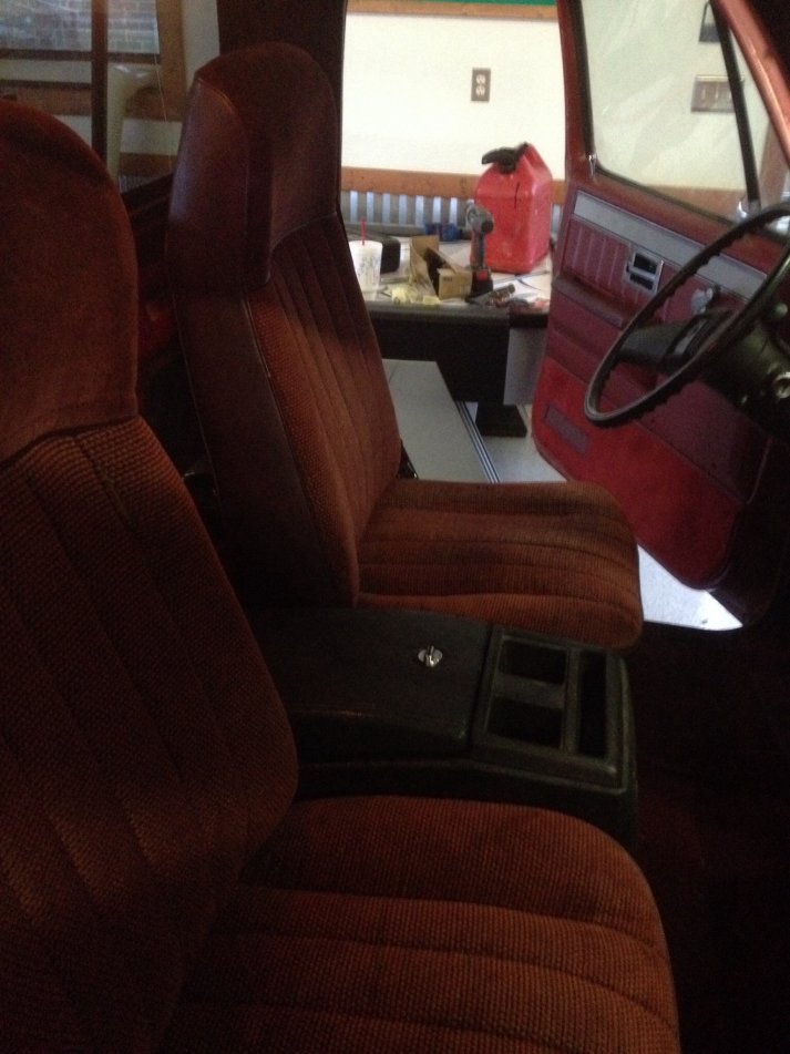

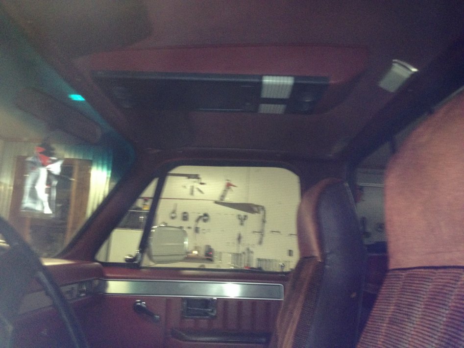

The overhead console

Thanks thunder, I think the guy I bought the suburban from told me they were actually out of a k5. The console is black, I may get some duplicolor later but for now I don't mind the contrast.

Looks good! I have a set of buckets like that I need to put in my truck, but I can't get excited about building brackets. I guess I don't have a center console yet either.

I understand that stroked, I'm going to try to heat and bend the bracket that's already on there, the front bend is correct, it's just the back that is off.

I used two sets of bench seat brackets to mount mine. Had to build a spacer for the right front to level the seat.( left front on passenger seat.)

Did the driver seat yesterday, your exactly right, used the two brackets from the bench seat but need to add spacer. Going to check the back seats in the suburban to see if the brackets are even close for the passenger. If not looks like some flatbar would be easy enough to bend and make work.

Would you like to take the time to share on how to do that mod? I did not think a Burb OHC was that short in a standard cab to fit like that. Looks good. Did you use the original Burb mounting bracket to mount that? What kind of headliner mods did you have to do to do that? Huh? Huh? :happy160:

Lol 89, you are correct. I had to cut the ohc. I wanted to leave both of the sliding door cubby holes but no matter which direction I measured from the cut ended up in the middle of one of those sliding doors. I cut it at one of the seams so it wouldn't look that obvious. I was going to use the bracket from the burb but looks like the roof was totally different (the burb had rails from side to side to mount to). I removed a few bolts on the ohc to remove the black plastic piece from the maroon and simply found the correct length screw to go through the plastic into the metal of the roof (first layer). I went through headliner and all. Reinstalled plastic piece and walla! I'll get some pics.

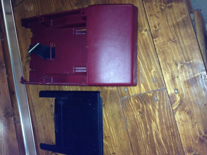

Here's the part I cut off, I chose this side to cut off so I'd still have all the map lights on the other part.

And here's how I separated the two, after I did this I just screwed through the maroon plastic and headliner into the cab roof. Then put the black piece back on and you can't see the screw holes.
