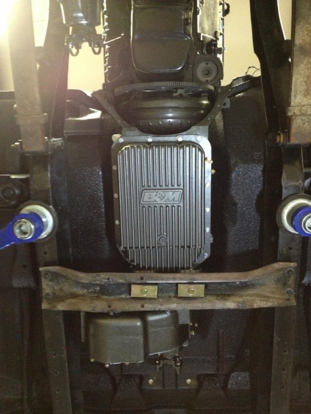

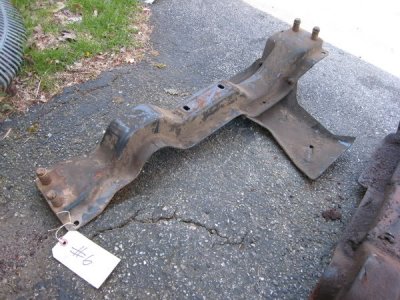

first pic is a 85 up cross member (not 1 ton)
second is my crew cab 4l80/205 with the 1 ton cross member
third is a 1 ton cross member to see how flat they are

I would have no way of knowing what crossmember they used :shrug: it's definitely a factory stamped gm unit. which is why I was thinking leave the xmember where it's at and raise the trans with a taller mount. front d line has a 1 inch spacer installed on front yoke. As I type this I'm thinking It'd probably be easier to jack the cross member up with a piece of bar stock with 2 holes drilled in it as a spacer.. is that acceptable? I am thinking so.

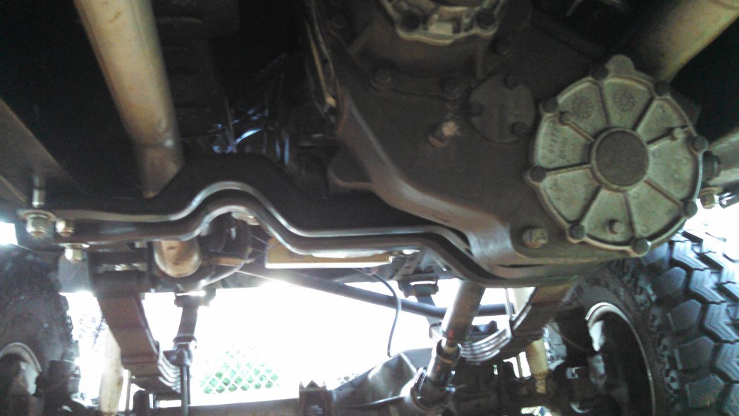

yep that is the 85 up cross member you need to space it up 2'' somehow

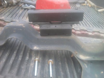

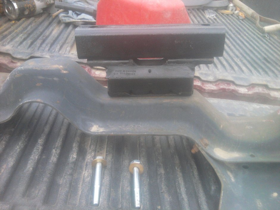

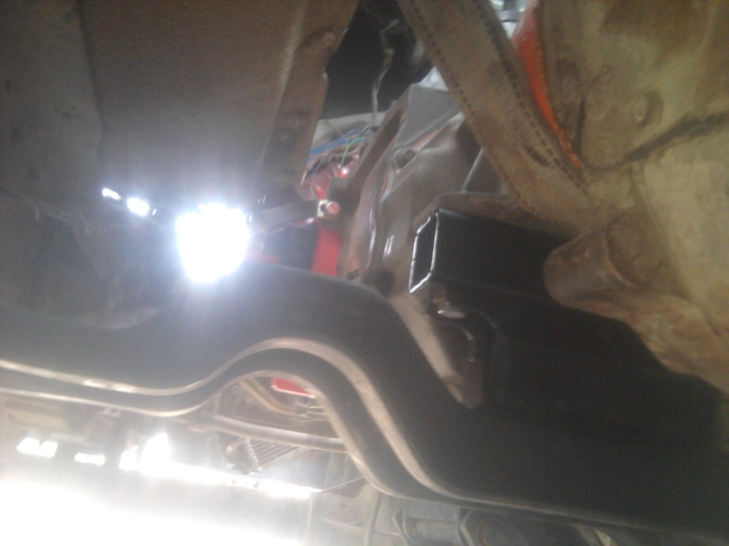

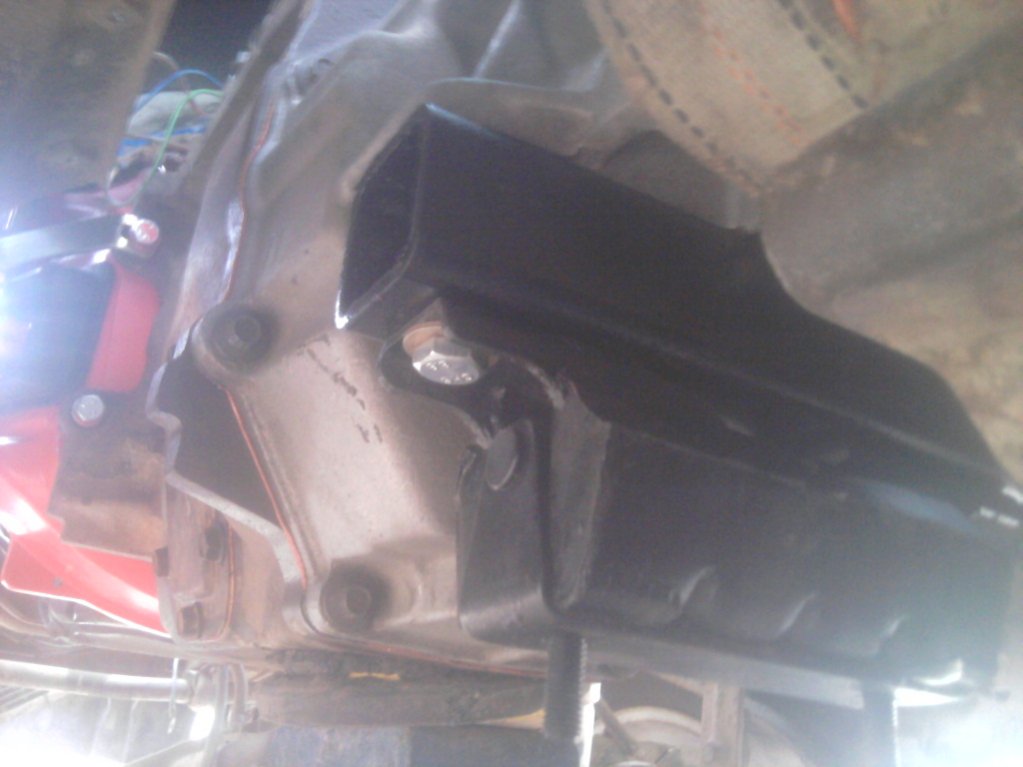

I built a spacer from 2''x2'' square tube I will post pics of it later tonight
I am going to use the same cross member that is in your truck with the 2'' spacer for now. if I have any problems with the cross member being low I will change it up later

here are some pics
I cut the square tube 9.5'' long witch was just a little wider than the flange on the nv4500
then drilled the holes just a little bigger than the holes in the mount for a little wiggle room

I was gonna do exactly like you did for now. What do you think about skipping the cross member to the inside of the C channel and building two spacers with a filler to fit inside the "hat" of the stamped member? It would be more work but you would gain ground clearance. And it'd appear stock which i also like...Another option I'm thinking is just bending up a custom cross member with some .120 wall DOM. I'd keep it bolt on as I'm not a fan of welding to frames if I don't have to.
kleedus
Jan 25, 2012
1,726
164
wyo
Ray
1960 threw 91
c10 to k30
350 threw 454
moving the cross member to the inside of the frame was my first thought
probably would only need an inch or so spacer on each side to space the cross member up after the thickness of the cross member
you would need to trim the ends of the cross member to fit inside the frame
I only went the easy way cause it was the quickest way to get it together for now
