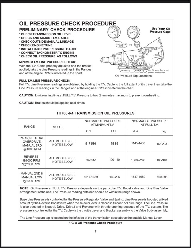

You will smoke a 700R4 to the ground in less than 5 miles if the TV cable isn’t correct. Go on Amazon and buy a pressure test kit then search YouTube for some how-to’s. It is super simple to get it right and the truck never has to leave the garage. The pressure kits are like $25. Adjust your TV cable in or out (in to increase pressure) until you are within the below specks, then you can drive it.
It will take way, way more time to have to pull the transmission

It's gone everywhere,the links I put up and all. I keep looking for info and post as I find it. I'm going to post a pic of the throttle valve and how it is supposed to operate,the thing is if the valve itself is worn you won't know without a pressure test. Also make sure your pedal at full throttle has the carb at full throttle.
